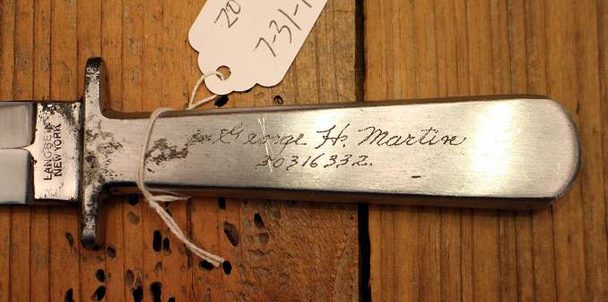

I figure folks here would have some advice on removing rust and stabilizing a family heirloom. My father carried this knife while serving on destroyers during World War II. It has come into my possession the worse for ware and I'd like to do right by it. I'd appreciate advice on what to do. Thank you.

Nice. That looks like a 1940s U.S Military Langbein stiletto fighting knife. Very rare . Does the tang say LANGBEIN / NEW YORK.
im sure that is one. For your interest

Thank you. It is soaking right now and after a bit more than a day a lot of the surface rust is gone, but a lot remains in what look like scratches. There's no warning on the bottle or in the many good suggestions here about soaking for too long, so I'm going to just leave it alone for a few days and we'll see what happens.
It does now show "C. LANGBEIN NEW YORK" in two lines on both sides. My dad's name and the date are engraved on one side of the handle. The metal around the Langbein engraving is very grey and dull looking. Theorizing that it is a plated piece, and the rust attacked the metal underneath where the plating was thin, where it was engraved or scratched.
