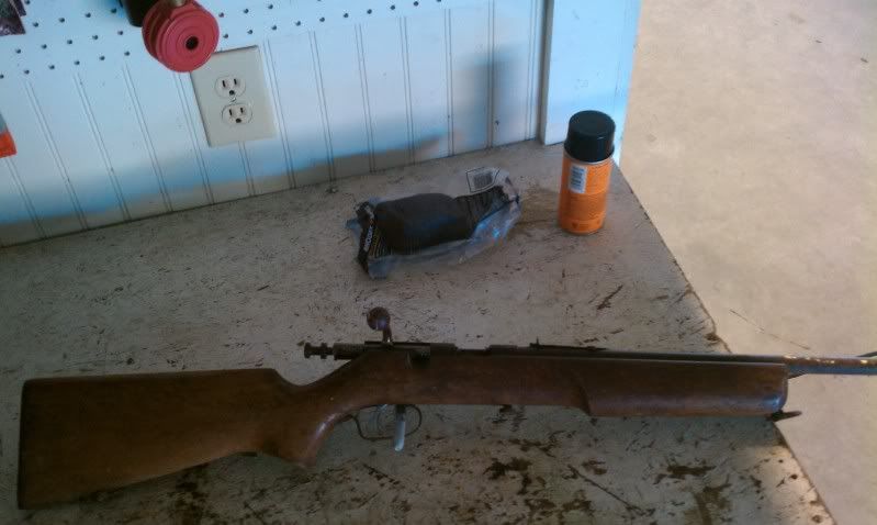

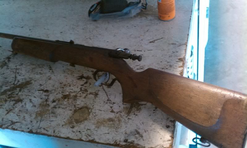

Ok, here is my Westernfield 37/Mossberg 30. I was given this gun by a neighbor that said it was sitting in his barn for the better part of 30years, and he never shot it. I looked up a little bit on it, and it looks to be just a cheap single shot bolt action made by Mossberg from 1933-1935 (correct me if I am wrong). It is mostly complete, except for the rear peep sight seeing as its missing.
What model peep do I need to get to make this gun complete?
Also, any comments on refinishing this gun? I cleaned up the metal with oil/steel wool and it looks ok, but still has some heavy rust on the end of the barrel. I was thinking of sandblasting and re-bluing or maybe getting it duracoated. As far as the wood, I will sand/stain/poly the stock as it is a gorgeous stock to me, but what color stain?
Any other ideas on what do do with the gun?
Are you certain that it is a Westernfield 37? I know that the cross reference on damguy's site ( http://home.epix.net/~damguy/models.htm ) shows a WF 37 as being a model 30, but it looks more like a model 14 to me. The only problem is that the D & T pattern is for a #4 (read: hard to find) or later sight and it is also D & T'd for a scope which would indicate a later model.

Is your 30 D & T for a scope? and does it have the semi-beavertail/
I just checked mine, It has the grooved stock, is drilled (single tapped hole) and milled with 2 vertical slots for the #3 sight, is not D & T for a scope and has the larger knob at the rear of the bolt. It also has an "automatic" safety that engages when the bolt is closed. To disengage it, you must pull back on the knob and turn it counterclockwise.
Yeah I am sure its a 37, thats what it says on the barrel anyway. Wards Westerfield Model 37 .22 S-L-LR

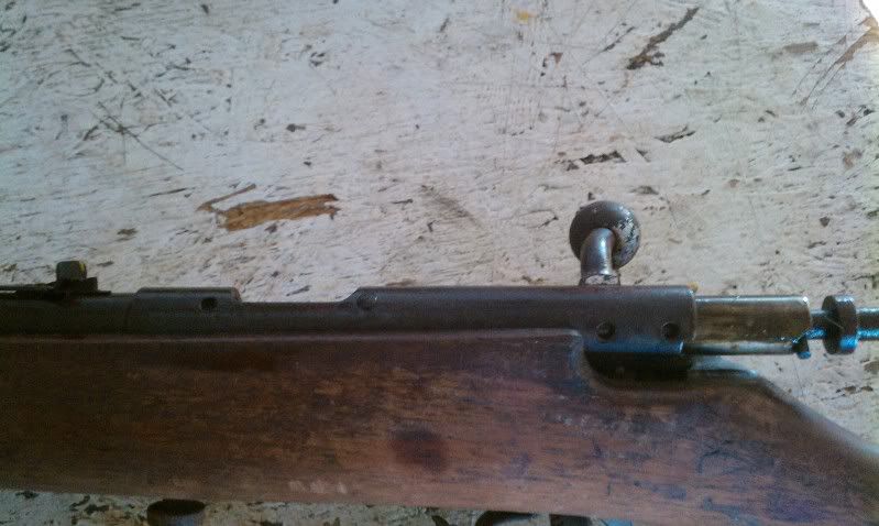

It is D&T (2 holes) on the left side of the reciever and then has the 2 holes I showed on the back.
The #3 sight mounts differently than all subsequent receiver sights. The 2 hole pattern that yours has is for the #4 and later sights. The notch in the stock at the receiver sight is typical of what you would find on one with a #4.

I have a W-T 37 rifle and a Moss 14 rifle.
My W-F 37 is identical to the Brandon21 rifle shown. With the # 4 reciever sight and reciever D&T'd for a scope base. With the sling swivle in front in the same location.
My Moss 14 rifle is a totaly differant rifle with a #3 reciever sight. The Model 14 has a totally differant bolt and the action is differant and shorter in length. The stocks on both rifles look almost the same but the Model 14 stock is about 3/4 inch shorter in OAL. The sling swivles mount the same. Since the Model 14 action is shorter in length the Model 14 action screw is about 3/4 inch closer to the trigger guard.

I pulled out the W-F 37 and Moss model 30 rifle.
The bolts are similar but many differances between the two. The cocking piece are differant. The cutouts out for the safety device are cut rather differant.
I don't feel the two bolts are the same even with upgrades. But who knows what Mossberg did.
