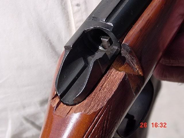

Stock: Badly chipped behind the bolt. 'Chequering' was nothing more than irregular diamonds scratched into the pistol grip. No points to the diamonds either. No fore-end chequering. Fore-end tip was painted black to simulate an ebony fore-end tip. Ditto on bottom of pistol grip. Cheap lacquer finish used. Stock re-finished with an oil finish and stippling to pistol grip and fore-end. Inletting was the worst I have ever seen. Inletting smoothened out to some extent (would have liked to do more but was pressed for time) and action was pillar bedded in the absence of glass bedding compound. Barrel was free floated. Action screws replaced at both pillar bedding points with hex bolts which are torqued to 5.5 Nm.

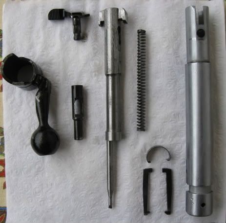

Bolt: Very rough. Bolt and bolt rails lapped to make it smoother.

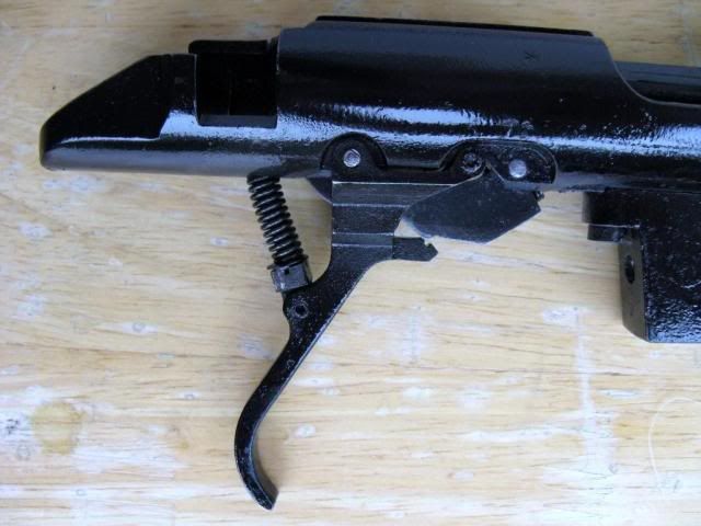

Trigger: Excellent! Made better by replacing both hinge pins with the new pins that are a tighter fit. This trigger is the exception as all the others I have tried have average triggers.

A couple of pictures of the trigger unit and stripped bolt.

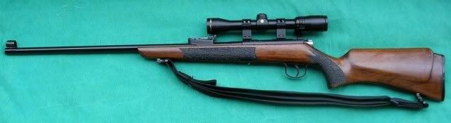

Over the years I have experimented with barrel lengths and it is now at 20" (the legal minimum in India) and it has become a reasonably good shooter. I have a couple of JnP CZ 452 striker springs on their way. I hope they fit as I faced ignition problems when I shot the rifle a few days ago.

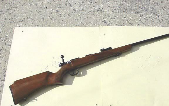

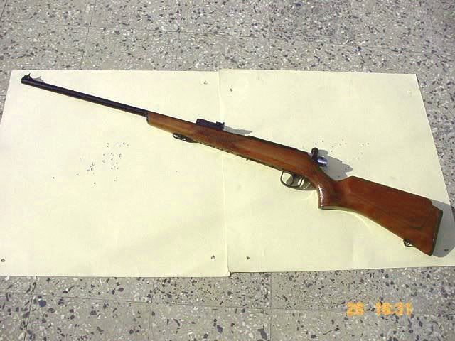

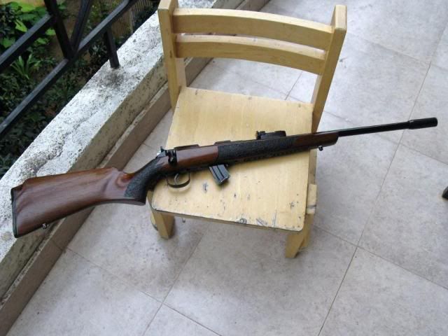

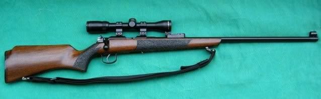

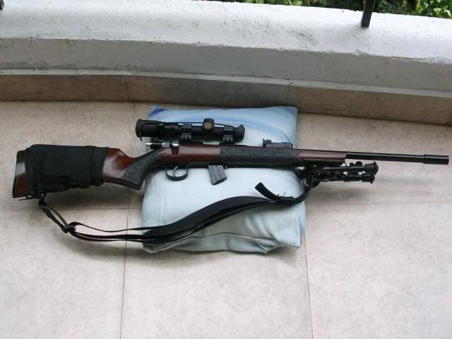

Herewith a few more pics of the rifle as it evolved into its currrent state.

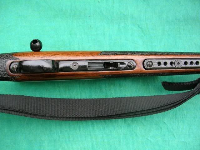

Hi Small! It's dark now but I will take some pics tomorrow morning and post them here. This rifle has some very rough and ready stippling - no v-groove borders and such as I lack chequering tools. Once I have sanded down the stock, I mark out the pattern with a pencil and then using the tip of the reamer on my Victorinox Swiss Tool I start tapping away. The 'taps'/indentations must overlap/intersect otherwise it does not look as nice. I prefer using the reamer on the bigger of the two multi-tools as it is heavier, in-line and the point is slightly rounded rather than a needle point. Put on some foot-tapping music and the entire process can be quite enjoyable. :D Once the stippling is done, carry on doing what you would normally do - stain, oil finish, conditioner / 0000 wire-wool and wax.
