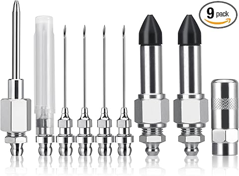

If it were me. If the end will unscrew i would use screw it. Then I would use a rubber grease gun tip and push it out with grease.
