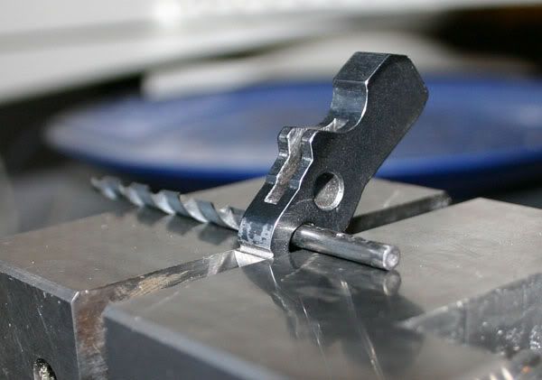

To improve feel and lighten your trigger pull, grinding/Stoning the the angle on the area of engagement of the hammer is one way to achieve a smoother - crisper trigger. Best of all it can be done yourself for free (if you already have the tools). The tools you will need are stones, vise and a 1/8" drill bit.

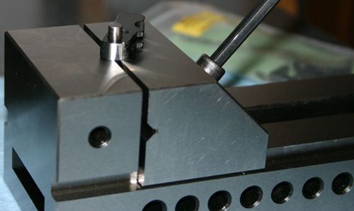

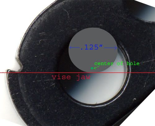

In short: Slide the .125" drill bit through the pivot hole of the hammer then set the hammer in a vise so that the drill rod is sitting on both of the vise jaws. When tightening the vise set the bottom of the sear notch in the hammer level with the top of the jaws. Then remove any material of the engagement area that rises above the the vise by stoning or grinding.
This is how the setup should look:
In this pic note that the bottom of the notch is at the top of the vise jaw (red line) to help achieve this you can insert a razor blade in the notch and push down if the notch is too high.

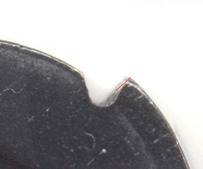

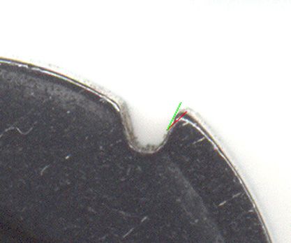

Here are some before and after pics, the difference is not very much.
How it works...
cletus hungwell said:
Changing the angle will reduce pull force required..... the extreme negative angle required to keep the hammer from slipping off the sear when it's dancin on it's pin during cycling is what makes the pull so heavy on the stock guns.......if you take a group out of a gun, you can watch the hammer being cammed to the rear as you pull the trigger...... what changing the angle does is reduce the amount of trigger pull force used to cam the hammer backwards against it's spring......the tighter the fit of hammer/sear to their pins, the less negative angle required......
of course, the combination of the two is what you'd go for when you're lookin for precision over reliability.... it's a balancing act, determined by your intended purpose of the group......
cletus
Why it works...

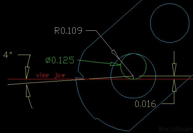

the angle is determined by a straight line running from the center of the pivot hole to the BASE of the sear notch....that line is 0deg.....
as most pivot holes i've checked have all been .218", that puts the center @ .109" from the edge of the hole....
(using a .125" rod in the pivot hole of the hammer) my math shows this will give a 3.9 degree angle......use the trig function on a scientific calculator to figure these....
it seems to me that the minimum angle needed will be determined by the amount of slack of the hammer/sear on their pins....the tighter the fit, the less angle needed... i do not have any hard numbers on slack vs angle at this time though......
any pivoting part's 0deg angle has to be a straight line from the center of the pivot point straight out through the edge..... this is the angle that allows sear movement w/o the hammer moving....... we have to add some negative to make up for the slack in the pins/parts.... to get this, we use a 2nd line, a negative angle intersecting the 0deg at the base of the notch......as this line extends past the base of the notch, the material climbs out over the sear nose, and creates the effect of the springs forcing the sear deeper into the notch....... the amount of angle, and the depth of the notch are selected based on intended purposes of the gun/group.....
Some angles to experiment with...
or, to get the desired angle, use .004" over center per deg....
0deg=.109", or 7/64's
1deg=.113", or a #33 drill shank
2deg=.117", a #32 is .116", add .001 shim under it!
3deg=.121", a #31 is .120, so, add a thou of shim stock....
4deg=.125"
these are approx figures...shim between the pin and the vise to get additional angle adjustments......
later
cletus

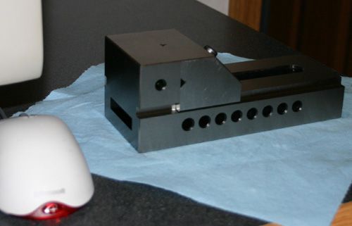

Yesterday at work I quickly fashoned a jig that mimics the setup in the top picture. I did this because I do not have a very precise vice at home. I stoned my hammer last night with good results. It lightened the pull considerably. Ill post a quick pic of the jig soon. Thanks for all the info you guys post.
Josh
BTW: Does the hammer need rehardening after this change?
#10 · (Edited)
This is the jig I made.
We had some ground stock that was going to the scrap bin because we switched to 420 SS for our dies. They begged to be rescued and put to use. It is just soft steel but I can always grind them flat again when needed. Where did you find a nice vice for that price? Hey that rhymes.
How do you get into the crook of the notch? I stoned what I could then wrapped a piece of 1000 grit wet/dry sand paper around a small swiss file.
Josh
Josh
thx for the info, josh!!!!.....
i REALLY like your jig for that!!...it should do alot of different jobs, if you can figure how to set it up!!!!
re: stones......i have a couple of triangle stones....a med india and a hard ark that i use alot.. the final finish of the surface will make a huge difference now, because you're actually feeling the sear slide across the hammer instead of jumping off it.... i have a hard paper buffing wheel i cut to a knife edge for getting up in corners like those....
thx for the eval!!....and, riskin your parts!!...lol...
later
cletus
