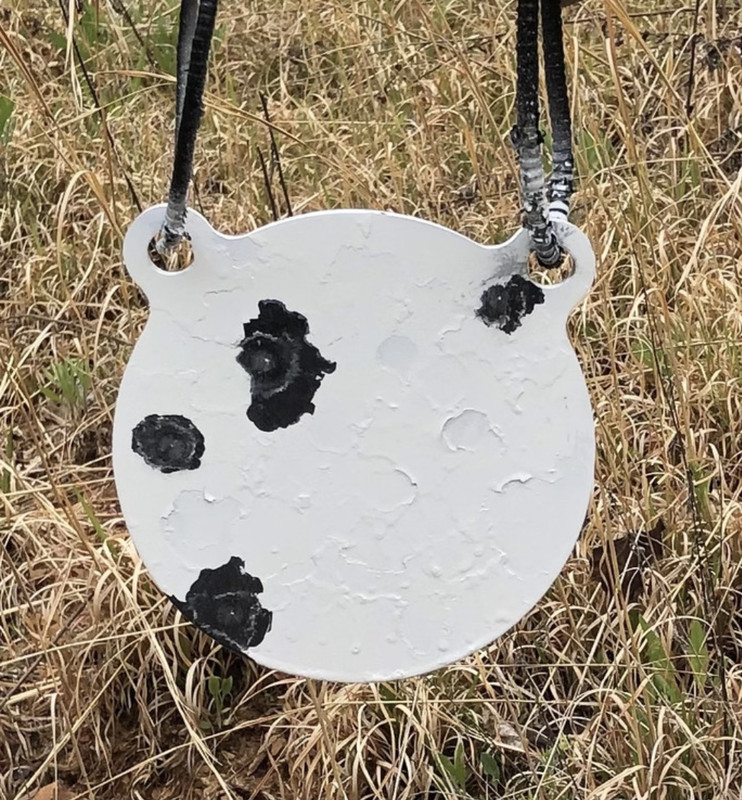

With the Lyman 17A front sight, the Marbles tang sight allows just enough elevation adjustment to successfully engage my 6” steel disk at two hundred yards.
Results with this Stevens Favorite using a thin post front sight insert in its 17A and LAPUA Biathlon Xtreme ammunition were satisfying. Virtually no wind. There are 5 hits, if you count the one on the right support cable. The tang sight elevation was set at 9 turns plus 3 clicks, using a six o’clock hold.
#7 · (Edited)
Another 10 shots with LAPUA Biathlon Xtreme on the 6” steel plate from this Stevens Favorite at 200 yards. A 2.4mm aperture front sight insert was installed, and overcast lighting limited target contrast somewhat. But, there was no wind, except for a light gust which blew shot #3 away to parts unknown. Elevation was set this time at 8-3/8 revolutions from the bottom to account for the center hold.
