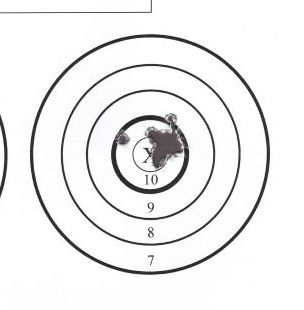

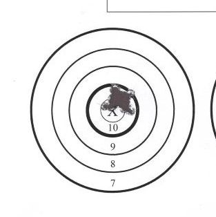

No wind or air movement was detected on the flags with the two groups below.

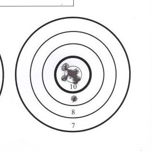

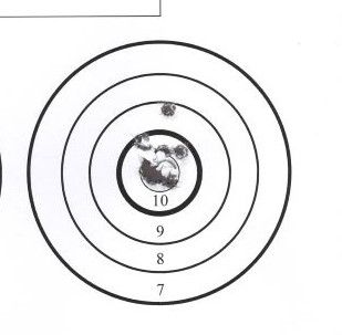

The next two seem like candidates for errant shots that can be explained by MV variation. In neither case, however, were the outliers either the fastest or slowest rounds in the groups

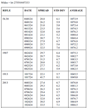

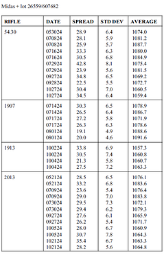

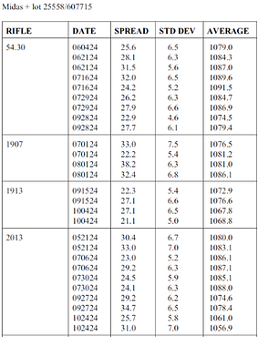

"They also have boxes with spreads well over 30 fps "
That's a surprise. You would think within a lot when they are supposed to all be from the same setup, that they would all look alike within the the lot.
In stuff that has a wide velocity spread, they "tend" to follow MV in elevation because the dispersion is so dramatic. But I agree, spread is not the only issue. When I say "a lot need to have less than 30 MV spread to be a good lot", I also say, "just because a lot has less than 30 FPS doesn't mean it will be a good lot". in testing I have had lots less than 30 FPS spread that I would not touch.
The temperature swings referred to are temperature related. The morning I shot the lot ending 333 with the 1913, the temps were just below freezing. That rifle barrel is the same length as the 2013 barrel, 69 cm or 27.16".
As it happened I mostly used my 1913 in October when temps in the mornings were cooler. If the 2013 average MVs are compared between mid-summer and October, the cooler month produced slower MVs.
As a general observation, with each rifle a second box of the same lot it was a little faster than the first because the temps almost always rose. Even a few degrees makes a difference.
