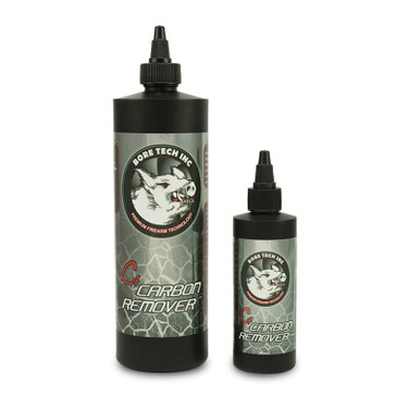

Excuse my ignorance, but I keep seeing C-4 and not sure what it is. Only used a couple cleaners in my lifetime.
Yep, it's this stuff:
As to how good it is or isn't, I like it.
I'd previously used things including Kroil, Hoppes No. 9, Ballistol, and contact cleaner.
Personally, I like the C-4 for cleaning a rimfire chamber.

Yeah, its expensive. So what, I know I waste more on stupid stuff that doesnt do me near as much good. The big bottle amounts to about 5 coffee's here.
Mark1964, I started using the visine bottle when I got the C4, mainly 'cause it costs cc $65 here in Canada:eek: The small bottle lets me dole out tiny drops, BUT Major Warning . . . Don't crank the cap too much, they're pretty soft. Made for disposal I guess. I've broken a couple and they don't 'glue back' very well. I started taking one to the range when someone said soaking b4 leaving gives extra time 'in the bore'.

But honestly you would have been so much better off and it would be more economical if you had of bought the big bottle instead of the small bottle.
You paid $19.99 for 4oz and for $34.99 you could have bought the 16oz bottle for less than twice the money and received 4 times the amount of C4 cleaner.
Shipping would have been a wash either way basically.
Buying the 4oz bottle make C4 cleaner a very spendy product to use.
