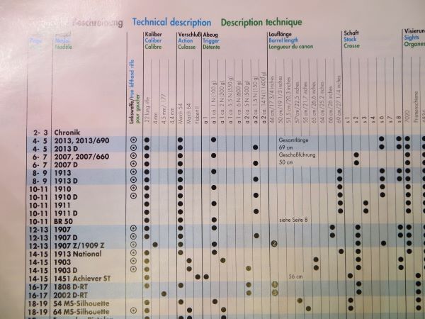

An Anschutz 1995/1996 brochure has the following, with the short barrel (50cm or 500mm) identified variously as 2007, 2007/660, 2007D.

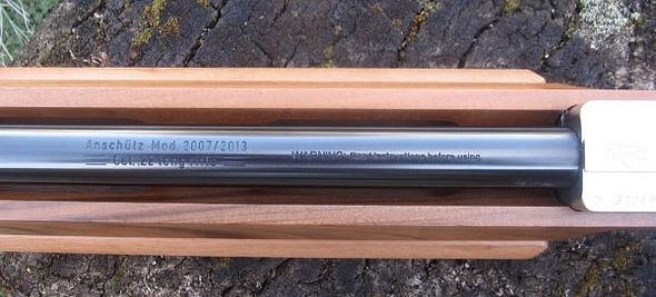

At least some of the 500mm barrels had 2007/2013 stamped on them, as shown on the one below.

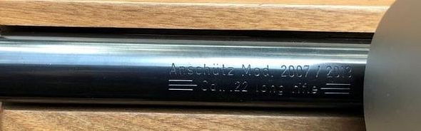

Below, the same stamp is on what appears to me to be a 660mm barrel. (The stock is an Anschutz BR 50 stock.)
