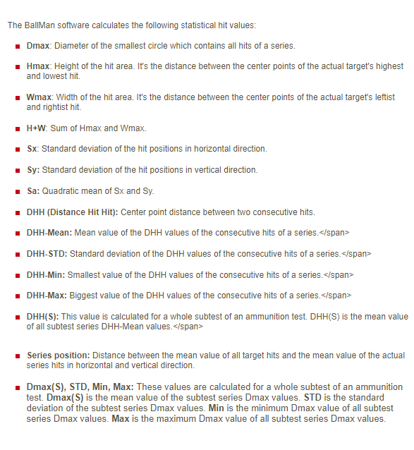

DHH means distance from hit to hit. When I sent a rifle to Mesa I was emailed a “definitions and explanation” pdf. I must have deleted it. If I remember I’ll ask for another Monday. I can’t say exactly what the mean radius is, but as I understood it (or didn’t) it values more what percentage of the entire group was in the center of the group. Don’t quote me on that.

Regarding the meaning of the various terms or abbreviations used in the target information, see below.
Thank you for the abbreviation definitions. (y)
