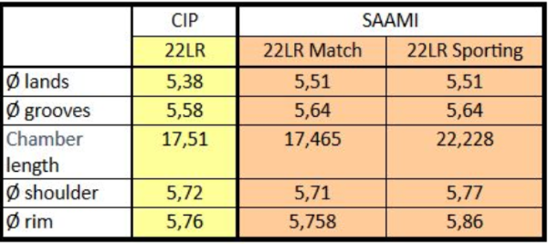

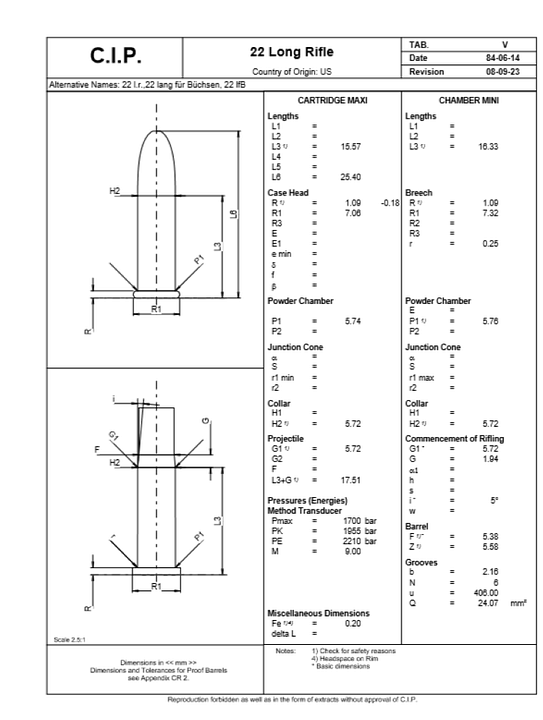

All CZ .22LR firearms are made to meet CIP specs. CIP chamber specs indicate the smallest or minimum dimensions of a chamber, including its diameter and length. Some chambers will have dimensions that are a little greater than these minimums.
CZ doesn't publish information about what differences in dimensions there are between the "CZ match chamber" found on models such as the MTR and the "regular" chamber on other bolt action CZ rifles. It's possible, indeed likely, that the semi-auto CZ 512 has a chamber with more generous dimensions than the bolt action models.
Below is the CZ chamber specs. For simplification CZ has produced a chart comparing CIP and SAAMI chamber and bore dimensions, shown at bottom.
