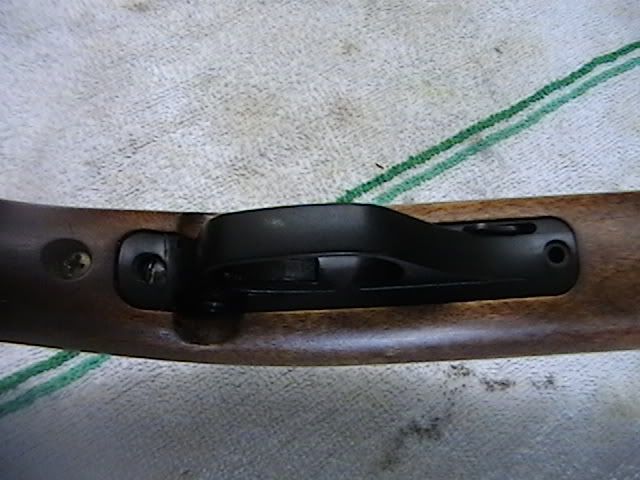

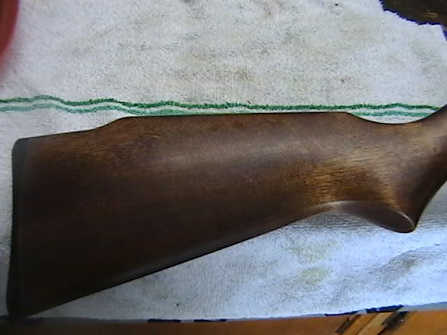

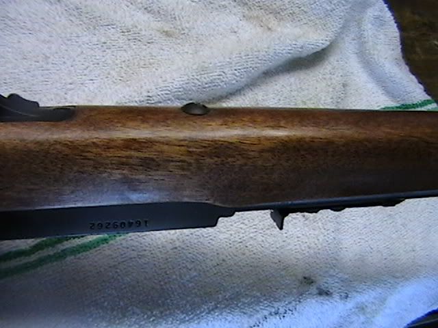

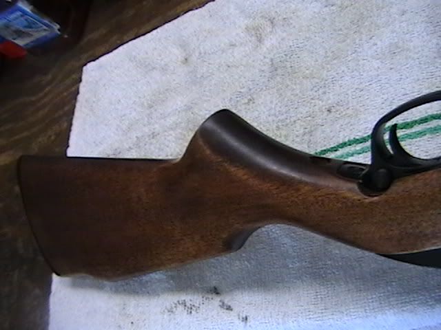

I have a 1984 model 60 i`m refinshing. I was wondering what the screw behind the trigger guard was for. It just screws into the stock with no visible function. I was also wondering what could be used to either reblue or repaint the aluminum reciever ( I think it`s aluminum ). The stock turned out pretty nice after a complete stripping and refinishing. The front screw and washer nut for the trigger guard is missing and after doing a search to find one i`m under the impression these folks are mighty proud of the screws they have according to the prices. If anyone has `em i`ll be glad to pay or trade ya for `em. I also had to glue the trigger guard rear screw hole back on. It really don`t look all that good but I`m going to use this for a hunting rifle and it`ll get bumps & bruies anyhow. Some of the stock accually turned out burnt looking and gives it a rough look. Hope ya like the pics.

I believe the screw behind the trigger guard is to strengthen the stock in that area. You will have to coat the receiver with paint or other coating as it is aluminum and won't take "bluing". I like Brownells Aluma-Hyde II as it is an air dried epoxy spray on finish. Also Brownells Gun Kote but this needs to be baked in the oven. Both of these finishes come in various colors. I've used the Aluma-Hyde II on a scope and am very satisfied. I've used the Gun Kote bake on spray on a shotgun and liked it also. You can get a new trigger guard to replace the broken one from one of the member's here made out of aluminum.
Flyrodder:bthumb:
The screw behind the trigger guard is a stock reinforcement screw, they had some stocks crack and break in that area on the earlier models and added the screw to avoid those breaks.
All three action and trigger guard screws for the 60 are 8-32 if you want to find some replacements locally. You can also order all the factory screws and the front trigger guard T-nut from Numrich, Brownells or Midway USA if you want. You can order a complete trigger guard assembly for $15-20 from them as well.
