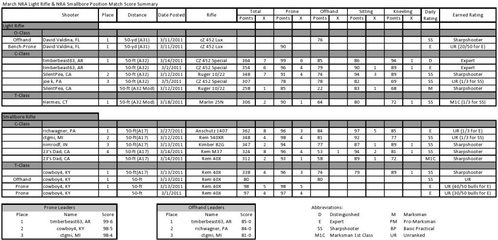

Post:
- 4P total and number of Xs, and each position total score plus number of Xs (or just your Standing and Unsupported Bench/Prone score with Xs) followed by your RFC name and state.
- Competition class (NRA Smallbore or NRA Light Rifle), Sight category (O, C, T class), and NRA Ladder Rating (don't forget to count just standing, kneeling and prone in Light Rifle class).
- Equipment used with details.
- Range distance and weather conditions.
- Pictures of the target if you can.
How?
Use http://imageshack.us/, browse for picture of your target, click upload, copy (Ctrl-C) the link next to words "Direct Link", in your RFC post use "Insert Image" icon (the yellow icon with the mountains) and paste the link you just copied. Image of your target should show up in your post.
E.g.
338-10X (80-1X, 83-2X, 85-3X, 90-4X) - BigGuns, FL
NRA Light Rifle, C-Class, Sharpshooter (missed Expert by 2pts 253 vs 255 - don't forget to count just standing, kneeling and prone in Light Rifle class).
CZ 452, Wolf Match Target ammo, BRNO Sights
Receiver glass bedded,
50 yd, Sunny, 86 Degrees, Wind 5mph at 3 o'clock gusting to 10mph

97-4X Prone, cowboy4, KY
NRA Smallbore, T-Class, Expert
Remington 40-X, Weaver T-24, Federal Auto Match ammo,
Jewell trigger (I have no idea, but definitely under a pound)
A-17 50 ft Sunny, 58 Degrees, wind was unnoticeable.
How many times do you see seven 10s and no X count? :banghead3 :shakehead
Did you gauge them?
By per our previous discussions of the smallbore rules, we'd sort of agreed that the "center shot" definition would be used to determine X counts on targets without an X ring.
See Rule 14.3.f.1 for a "Center Shot"
" Any shot hole touching the ten ring but not touching the outside edge of the nine ring with the aid of a .22 caliber plug type scoring gauge."
Therefore: I'd guess that bulls 4, 5, and 10 are X's and 2, 3, and 7 are possibles -depending on the gauge results. You may want to revise your score :bthumb:
If we start getting too many perfect scores, we can always go to Rule 14.3.g for "center shots of higher value" and only allow an X to be scored when the 10 ring is completely obliterated with the gauge.
But for me, and based on my obersations of the previous scores, we're doing okay with the more lax definition of an X
Nice shooting too!
Nice catch! I had forgotten the procedure.
You're right. 4, 5, 7, and 10 are Xs. I thought we were using the "completely obliterated" 10 ring for an X interpretation. I guess a re-read of the rules is in order. :eek:
I'll do an edit.

354-6X Prone/Standing/Sitting/Kneeling: 96-4X, 79-0X, 90-1X, 89-1X) - timberbeast63, AR
NRA Light Rifle, C-Class, Expert class 264-5x (prone, standing and kneeling)
CZ 452 Special, Winchester SSHP ammo, BRNO Olymic sight, 2+ pound trigger
50 ft on A-32 target, overcast, 68 degrees, 1-2mph wind.

348-4X (98-4X, 81 92, 77) - ctgmi
Smallbore, C-Class, unclassified
Remington 540 XR, CCI STD, Redfield
Modified Trigger
50-ft Indoors
Really need to work on the kneeling position, just can't seem to get my body locked.

A32 @ 50 ft
348-7x (91-4x,74-0x,94-3x,89-0x) SilentPea, CA (prone, offhand, sitting, kneeling)
Sharpshooter (254 subtotal = 3/3 for SS).
A32 modified @ 50ft
A32 @ 50 ft (85-0x, 22-0x, 83-1x, 68-0x)
Marksman (175 subtotal)
Ruger 10/22 in Boyds Tacticool stock, CCI Blazer, Williams peep rear w/ Lyman aperture front, Trigger stoned to ~3 lbs
mixed skies, 65 Degrees, 15mph wind from 12 and 9 o'clock

338-5X cowboy4, KY
Prone: 96-3X, Offhand: 74 (ouch!!:banghead3), Sitting: 79 (ditto :banghead3),
Kneeling 89-2X :)yippee: :2p...well, its good for me :D :beerchug:)
NRA Smallbore, T-Class, Sharpshooter
Remington 40-X, Weaver T-24, SK-Standard Plus ammo,
Jewell trigger
A-17 50 ft Sunny, 59 Degrees, gusty winds, but limited as a factor.

347-2X (94-0X, 77-0X, 87-1X, 89-1X) - Nimrodf, IN (Prone, Offhand, Sitting, Kneeling)
NRA Conventional, C-Class,
Kimber 84G, 50ft A-17s at the MSU Demmer Center

364-8X Prone/Standing/Sitting/Kneeling: 99-6X, 85-0X, 86-0X, 94-2X) - timberbeast63, AR
NRA Light Rifle, C-Class, Expert class 278-6x (prone, standing and kneeling)
50 ft on A-32 target, overcast, 72 degrees, 1-3mph wind.

312-2X (93-1, 58, 89-1, 72) - 23's Dad, CA
Smallbore, C-Class, Sharpshooter Ranked but Marksman 1st Class scored
Remington 40X, Federal Bulk ammo, Redfield Olympic rear sight, Tigersight front, Factory Trigger
50-ft Indoors, 65 degrees, Blower Downdraft in lane
I'm still waiting on that Merit aperture...stupid back-orders
324-8X (96-4, 53-1, 94-2, 81-1) - 23's Dad, CA
Remington 37, Federal Bulk ammo, Remington Factory M37 rear sight, Tigersight front, Factory Trigger

Got this done a little earlier since I'm going to be in Taiwan for the next two weeks. Could use more practice. Concentrated on practicing the standing position, so haven't looked into a sling yet. Main issue there is the 25N doesn't have any attachment points, so if I'm going to continue using this rifle at some point I'm going to have to just modify the stock to make attachment points.
306-2x (90-1x, 64-0x, 80-0x, 72-1x) Hermes, CT
Light Rifle, T-Class, Marksman 1st Class (I think this set completes the qualification for that class)
Marlin 25N with Bushnell Trophy 4x32, Federal Automatch ammo
A32 modified at 50ft at indoor range

You actually scored Sharpshooter!
By my count, you shot 226 on the Prone, OH, and Kneeling. That's Sharpshooter! For Light Rifle, you use these three positions only for classification. The sitting position is an add-on. I think you were looking at the 4P Aggregate table for your post. The 4P Aggregate is for the Conventional Smallbore Class.
You may want to get a scoring gage too. I think you left between 4 to 7 points off your score that a gage might have given you.
