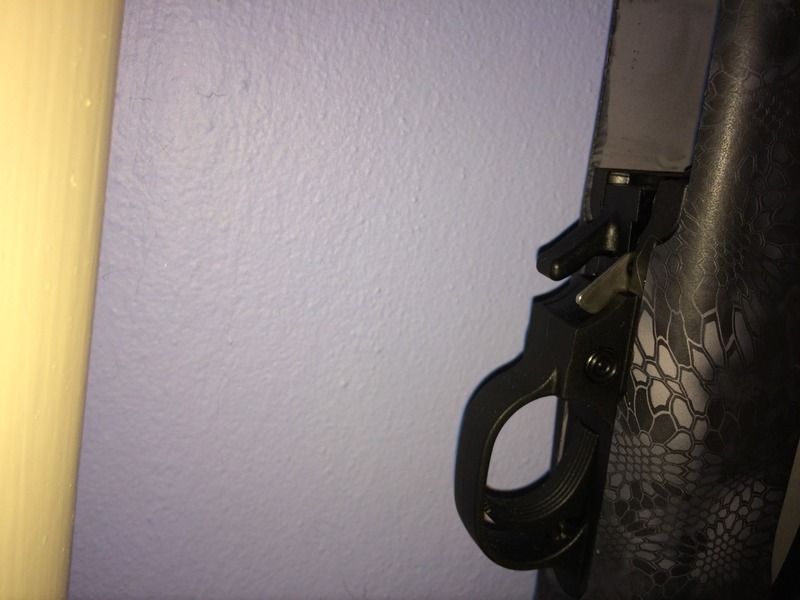

Timely post here... I just installed a Volquartsen mag release yesterday. Went to the range and it was like a new gun... the process... adjusting to just pushing that little lever forward instead of holding the rifle, putting my right hand under there to press the factory mag release button.
Doesn't seem like accidentally pushing it will be an issue.
I'm a fan... and I like the fact that it's metal, as some I looked at were poly.
