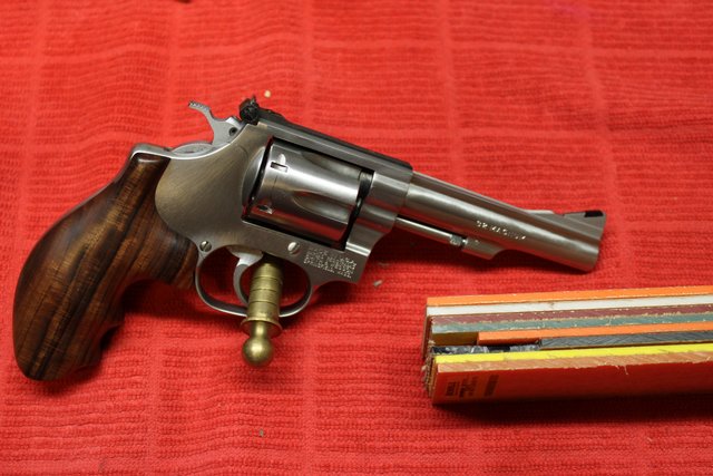

I recently purchased a new S&W 63-5 .22LR at my LDS. They apparently are rare and I was in the market for a .22 revolver of this size, so, I jumped on this one. I love the size, how it handles, looks, etc.
However, I wasn't crazy about the sight picture at the store, but, figured I could do something about that later. Well, it's later and I have done a lot of research to find replacement sights that would work without modifications and have pretty much come up emptyhanded.
Options that I have considered are:
  1. Locate a replacement rear leaf and file it down so that the orange circle in the front sight is entirely visible. I don't want to alter the original part in case it needs to be restored to original condition.
  2. Replace the pinned Hi-Viz front sight with a plain black one that has the correct height and width and hopefully fits the factory ramp and pin position.
I am leaning toward option 1 as it appears to be the easiest to accomplish, if only I could find the replacement part without having to purchase the entire rear sight assembly, which would cost around $75 with tax, S&H.
So, what have you done to your 63 to overcome the sighting issue without a lot of expense, time and frustration?
I don't care for the "setting sun" effect of the too-large diameter fiber-optic front sight insert paired with the too-shallow rear sight notch. Unfortunately, there isn't much to be done with the rear sight. From what I could learn, the rear blade is unique to this model and isn't commonly available. Also, I believe that S&W revolver rear sights are commonly disassembled by tightening until the windage screw breaks and then reassembled with new parts, which S&W won't sell.
I think your best bet might be replacing the front sight.
I haven't checked with Dawson Precision, yet, but they might make a replacement fiber-optic front sight for this gun. It is worth a look.
Please update us with any solutions you find. Thanks.
Update:
I resolved the issue by purchasing a rear sight assembly from Midwest and filing down the notch with a little round file from a cheap set I purchased at Harbor Freight. I then touched up the notch with Birchwood Casey flat black paint. I can now see the entire orange dot thru the rear sight.
I thought about and researched replacing the front sight. But, acquiring an aftermarket front sight (no factory ones available) and having a gunsmith install it since it is such a delicate process made the cost more than my method.
It can always be restored to factory with one screw - the front sight option not so much.
Some updates that may require a gunsmith are to replace the hammer with a target version and ditto with the trigger. S&W really could have done a better job with this version of the 63. For now I will just shoot it and determine whether or not to go forward with any more corrections...er...changes.

Sent 63 to S&W service yesterday, 4/18, after two trips to the range, as it was near impossible to fire. The rear of the cartridge case being positioned to fire at the top comes into contact with the lower part of the firing pin bushing, causing a near freeze-up condition of the cylinder requiring both hands to rotate to top position. The bushing is very slightly rounded, just enough to raise the middle of it above the frame with insufficient clearance for the cartridge case.
I had read reviews regarding how S&W quality and QC have gone south over the years. But, these are few and far between and I really wanted a good SS .22 revolver. So, I took a leap of faith. I was quoted 4-6 weeks turnaround time, which is probably optimistic.
I will update again after receiving it back from service dept. and a trip to the range.
