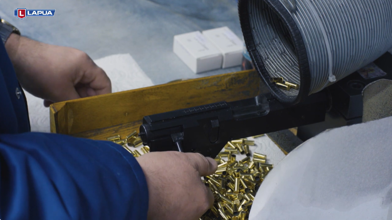

YT videos of Lapua Rimfire Production from 8 years ago
Curious does anyone know of any newer videos available? Only so much you can glean from watching this. Three things stand out:
1. Optical QC systems to check the primer application consistency at 1:03
2. Test fire at 1:17 UPDATE looks like they test with KK200 action & KK300 trigger. This appears to be a barrel vice and not an action vise.
3. Trefferauswertung Nach 26 Schuss (Hit Evaluation after 26 shots) Center-X results at 1:24 (23mm) hope that's at 100M not 50M.
The videos are more marketing than technical info but still cool to watch. Again, does anyone have a link to anything in addition to this YT Video that would show how they are making the ammo today?
2. Test fire at 1:17 Looks like Anschutz barreled action. Very likely easy to change barrels. This appears to be a barrel
Yes, to my old eyes it looks Anschutz and an older rifle, the bolt has a flat cap (earlier) compared to newer ones which are rounded/domed shaped.
Then again, I have little or no experience with new modern Anschutz rifles as mine are all old models.
Vids like this from Lapua or Eley Tenex will not give away any trade secrets, alas those secrets are not for the end users.
