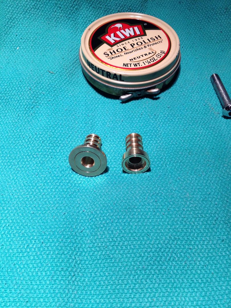

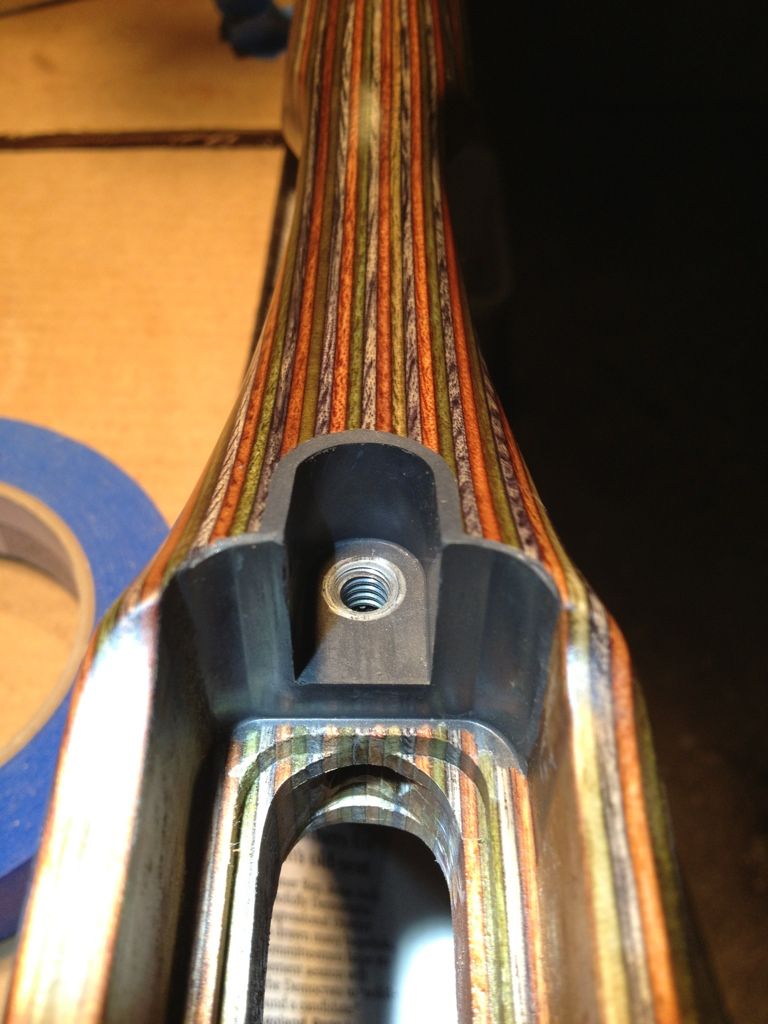

I am a user of Devcon Plastic Steel Putty, for bedding; however, the best grouping of any bedding I have done, was with JB Weld, original, with KiWi, natural shoe polish. I bedded the rear of stock, and first 2 inches of z-block, with A-683 for pillar, and 1/4 x 20 take down screw. Resulting with .0XX groups at 25yds, with Leupy 36X, Clark 21 inch barrel, in a Fajen stock.

Better results with one epoxy over another has nothing to do with the kind of epoxy. The man who built 3 of my custom varmint rifles, uses a dial indicator to check for any toque left after bedding, and if there is any torque at all when loosening the action screws, he will remove a tad of the bedding, and apply another thin layer, and keep going until its perfect.

I used to use Brownells Acraglas Gel with their Aluminum Powder mixed in, but went away from Acraglas as it never felt completely hard to me - you could just mark the surface by pushing a small screwdriver tip into it. The last 2 rifles I did I used Devcon Plastic Steel. It is a bit runny to deal with but mixing Al Powder with it improves it to butter consistency .The next one I do I have a pot of Marine-Tex to try. For a release agent I have used Brownells (the alcohol based one) and one one occasion car wax. I have not used Kiwi but have onle heard good things about it. A mate, who does lots of bedding uses a Ciba Geigy mould release agent. I have yet to end up with a one piece gun but always hold my breath as I separate the action from the wood. :( as always spend lots of time doing prep including temporary dams to contain the compound and masking on exposed barrel where the goo oozes out on to.
