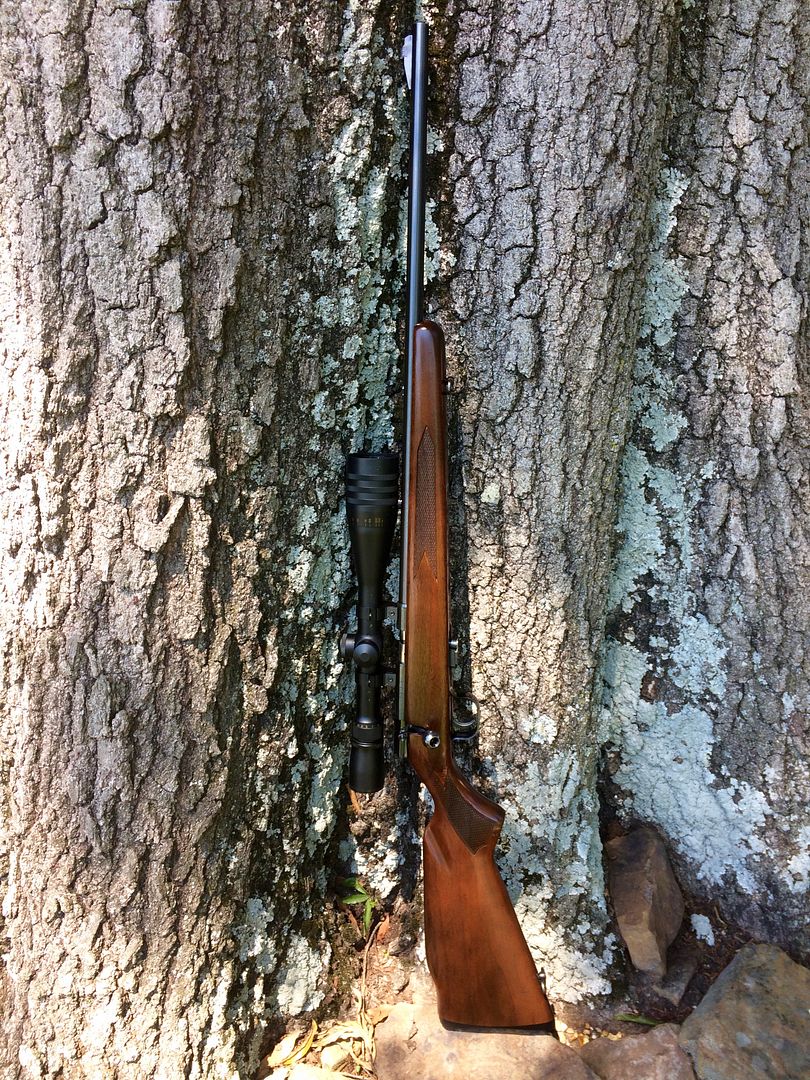

Lo and behold, a 320 toter walked in the door at the gun show yesterday. Luckily, my book table was near the entrance and I didn't have a customer at that moment. As he sauntered by, I struck up a conversation and after examining the 94% :) rifle, I paid his price. His story was - he bought it at an estate sale a couple of years complete with an old steel tube Weaver KV 2.5-5 variable on it. I must admit they looked cool together, but I wasn't going to risk a bad initial outing with that old yellowed glass and post reticle. I thoroughly cleaned it today and mounted my Weaver V-16 on it. Range, here we come in the morning.

The Warne 7.3/22 rings on the Weaver V-16 did not securely engage the 320s little tip-off grooves. I tried reversing the jaws, but the other jaw positioning was no more secure, and even worse, it was canted.
Instead, I used a nice old Weaver K3 I had on hand with sharp-teethed Weaver 1" tip-off rings. This scope seemed a better fit aesthetically as well.
Given the 3X scope, I decided to test at 25 yards. Here is a target fired with American Eagle 38 grain plated hollow points.
I'm not kidding, folks. This was the best of the morning. It hated the greasy SK Magazine and waxy Aguila Standard Velocity. After those, I said, "Well, Danny Boy, maybe it's like your Remington Model 5 with a preference for high velocity plated bullets." I had a box of the plated ammo in my bag and used it to shoot the target pictured above.
I don't know if I want to put the effort into it or not (bedding, opening up the trigger housing, etc.). That final group on the center dot ain't half bad. Maybe I'll just consider it "collected" and take it to the range for an occasional plinker's outing.
