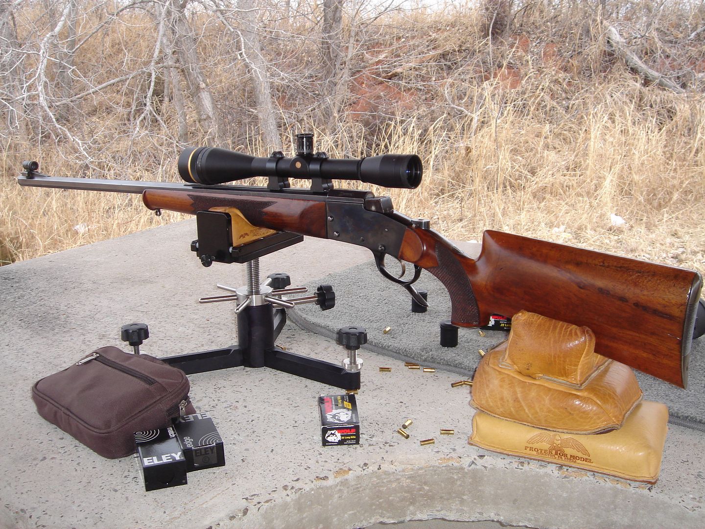

The Haenel
The Haenal exudes quality from every surface, and, as one who has designed and made a few scratch-built falling block actions, it is clear to me that the designer understood completely the challenges and idiosyncrasies inherent to a .22 LR falling block rifle. Specifically, almost all falling-block .22 LR actions leave precious little room for loading and removing the small .22 LR cartridges and/or spent cases. The receiver walls just get in the way of fat adult fingers, like with the aforementioned BSA Martini, and even on the "low walls" of the Winchester 1885 Low Wall. This is exacerbated when mounting a scope. Not so with the Haenel. As can be seen in the pics, not only are there no walls to impede access to the chamber, the top of the block is flat with a nice little milled trough for sliding a cartridge right into the chamber.
Another problem involves extractors. The extractors on many falling block designs do not adapt well to the small rimmed cartridge, and designers in the past resorted to reconfiguring them to ensure reliable function, as Winchester did on its rimfire versions of the 1885s. The problem usually lies in the pivoting extractor design and the short travel. Anyone who has attempted to convert a Ruger No. 1 to rimfire will understand what I'm talking about: the downward pivoting action, combined with usually minimal engagement at about the 9:30 position, just above the centerline, tends to bind the small case, especially in a tight match chamber. Winchester used a pivoting extractor, but its design engages almost 180 degrees around the lower half of the rim and adds an ejector. On the Haenel, although there is no ejector, the extractor engages a larger part of the rim and telescopes straight out from the breech face, like a SxS or OU shotgun extractor, somewhat reminiscent of the CD drawer on a computer opening for loading. It also features much more travel than the average pivoting extractor, just enough to clear the 22 LR case mouth, at the expense of a bit of leverage…probably the perfect compromise, though, since the short, spent .22 LR case usually requires greater travel to allow finger access to the case, and not great extraction force.
The Haenel is a striker-fired, falling block rimfire design, so there is no external hammer, and there aren't many of those around (the BSA is technically not a falling block action, although some would argue it is). The Haenel features a square-headed screw, protruding up just behind the block, that allows adjustment of its two-stage trigger. The face of the trigger is very nicely checkered, adding a touch of class. These rifles usually have a thin, sheet metal band, or strap, secured by a cross bolt through the receiver and two serrated screw heads, that wraps around the top of the receiver to cover this adjusting screw head. This rifle no doubt had one at one point, as evidenced by the proud screw heads seen in the pics. I have read that this cover is to disallow access to the adjustment screw during a match, after all the triggers have been adjusted to the same weight. Maybe. In any event, the trigger release is light enough but is less than stellar -- quite mushy and creepy -- a surprise, given the overall quality of everything else on the rifle. In this regard, the Martini is far superior, at least to my Haenel.

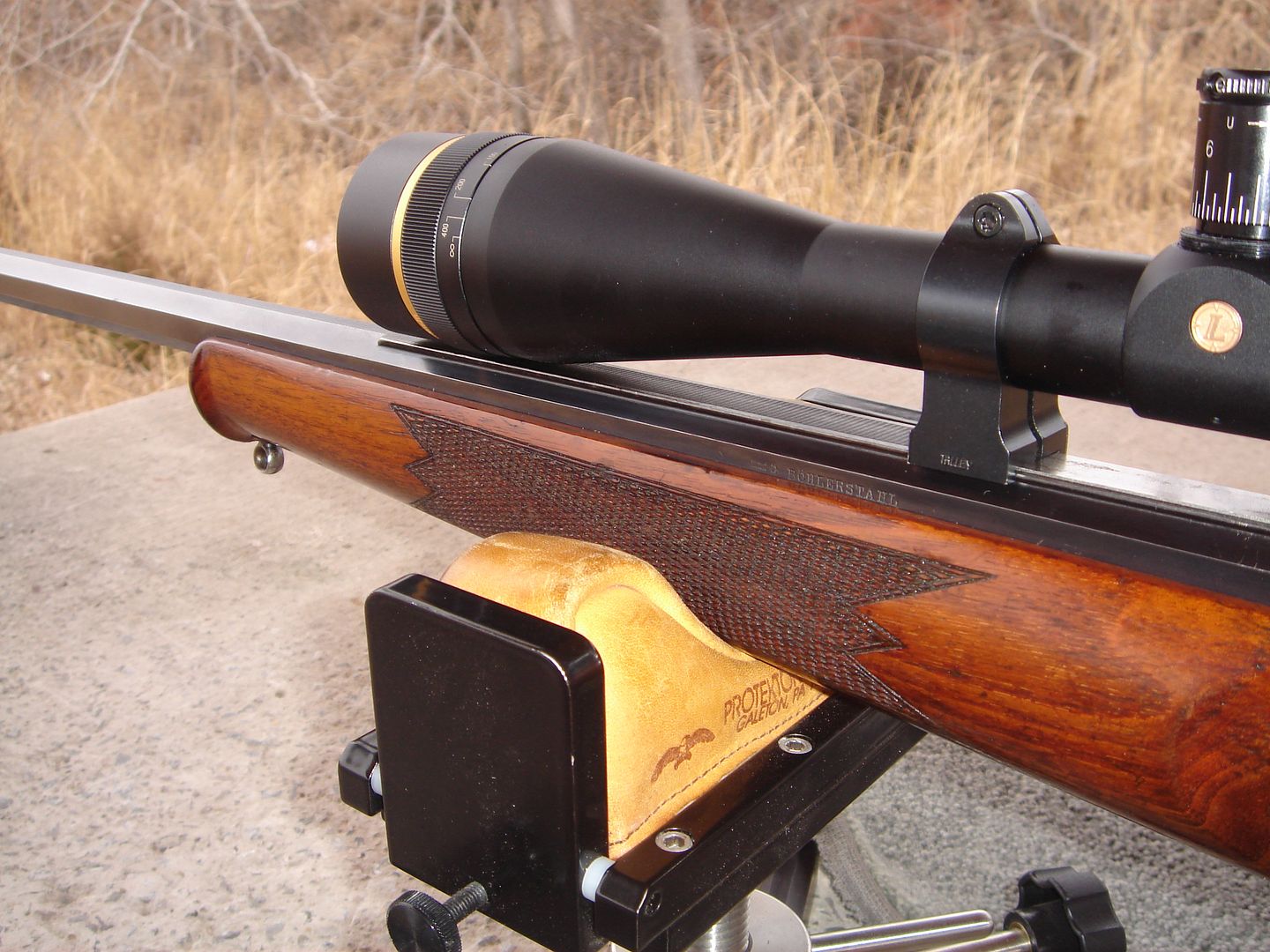

The Haenel also boasts a gorgeous, wide, integral matted rib along the rear portion of the top flat of its tapered octagon barrel. The top flat remains matted to the muzzle, imbuing the rifle with a wonderful elegance.
The wider rear portion forms a 16mm male dovetail, allowing a perfect fit for 16mm Brno #1 or 527 rings, although its purpose was likely for a barrel-mounted open rear sight. As you can see, my Talley rings were about .020 too low to allow the objective bell to clear the barrel, so I had to use a .028" shim between the barrel and the rings.
This is less than optimal, since the ring claws now have a shallower bite into the dovetail, but I had to do something to mount a scope for this report, and slightly taller rings will provide a permanent solution.

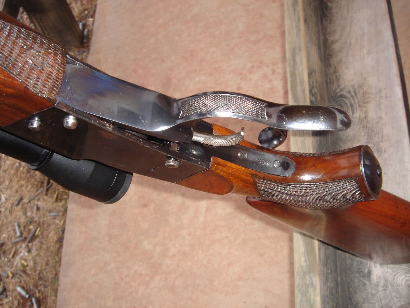

The elegant and tastefully checkered (top and bottom) operating lever is smooth and positive in operation, providing plenty of leverage, just like a good "lever" should.
The cocking stroke is quite short, meeting resistance just when the top of the block aligns with the chamber. Further lowering of the lever of about ÂĽ" causes the extractor to actuate, protruding quickly, like a child sticking out its tongue. Releasing the lever allows the spring to return the lever to the timed position level with the chamber. The timing is perfect, and the fit and finish are such that it is difficult to even see the extractor when it is retracted.
