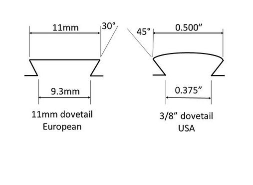

Be careful, heres a chart. Fyi the 3/8 ths are wider than the 11 mm cause they measure those inside cut to inside cut and the 11 mm outside cut to outside cut.
As for the cut angle on the gun vs on the rings, sorry , i dont know. Lots of folks use and Love the Talley Rings. Buy them from Amazon , easy to return.

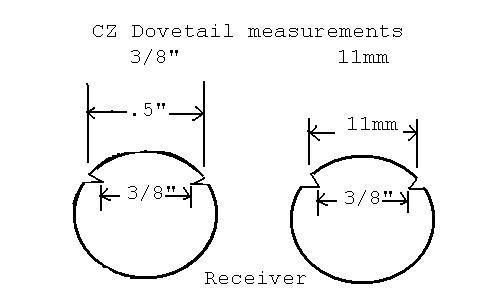

Don't know if this will help you or not. Measure the top of the dovetail, if it's about .500 then it should be 3/8" and if it measures about .430" then it should be 11MM. The 452 and 453 rifles dovetails varied by caliber and the rifles version (American, Lux, Varmint, ect.), The 452 Full Stocks used 11mm in 22 L.R. but 3/8 in 17 HMR and 22 magnum. Supposedly all the 455 and 457's are 11mm dovetails but I haven't a 457 so can't really comment on them.

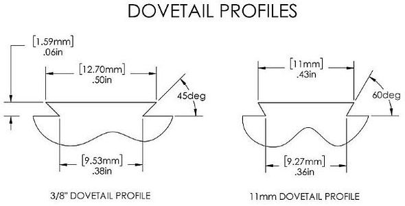

I make the rings that TeeterTotter linked to.
It seems most of the ring manufacturers gloss over the 3/8" vs 11mm dovetail difference and make a one size fits all ring. The 3/8" dovetails are 45 degree dovetails and 11mm use 60 degree. These one size fit all approaches do work and so will $5 chicom rings but it's not a good mate with at least one or the other dovetail. Can't mate well with both.
As far as I know my 3/8" dovetail rings are the only ones made just for the cz 452 American. I have also found that there really isn't any standard for 3/8" dovetails. As i said, my rings are made to fit the 452 American and I have tried them on a Remington 580 action, which also has a 3/8" dovetail and they don't fit at all to my satisfaction.
