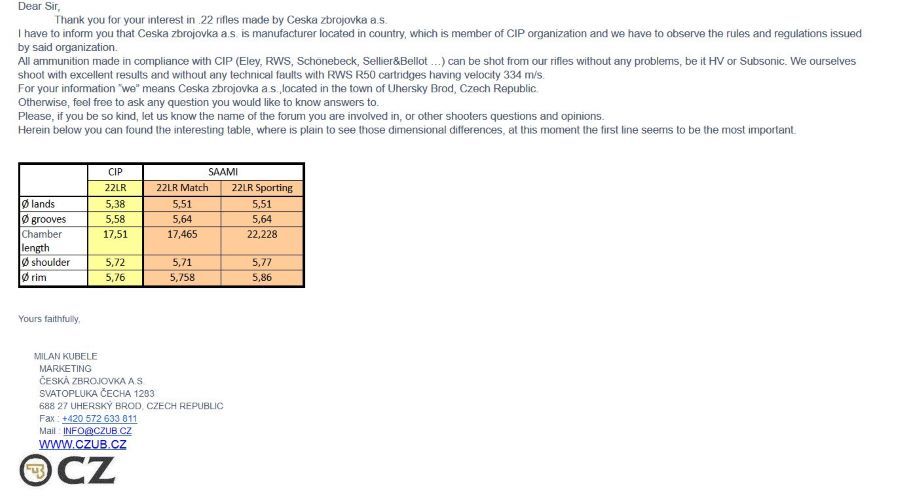

The insinuation in CZ website assertions aside, the fact remains that CZ firearms are manufactured to CIP specifications. They don't have a tighter bore than the regulations allow. Other European manufacturers adhere to CIP, while most North American factory rifles stick to SAMMI.
Cleaning rods that are made for .22LR should work in CIP-spec bores. If they don't, the rods are not suitable for any CIP-spec bore.

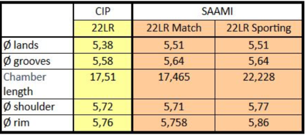

Below is a comparison furnished by CZ itself. It shows that the lands are 5.38mm or 0.2118".
As I wrote, I was surprised to find the problem as I have used the same rod with my 452 American 22 LR. In its current condition with huge gouges in the coating and damage from literally hammering it out of the 457, I will be retiring that rod and getting another. A 20 that can take a 22 jag is what I will be looking for.

As I now understand the origin of the problem and have a plan to solve the problem, I think we can retire this thread. I particularly appreciated the chart on the differences between CIP and SAAMI standards for chambers and bores that was included in Reply number 21. That was very informative and exactly the kind of information I am always hoping to get in replies to my more serious posts.
