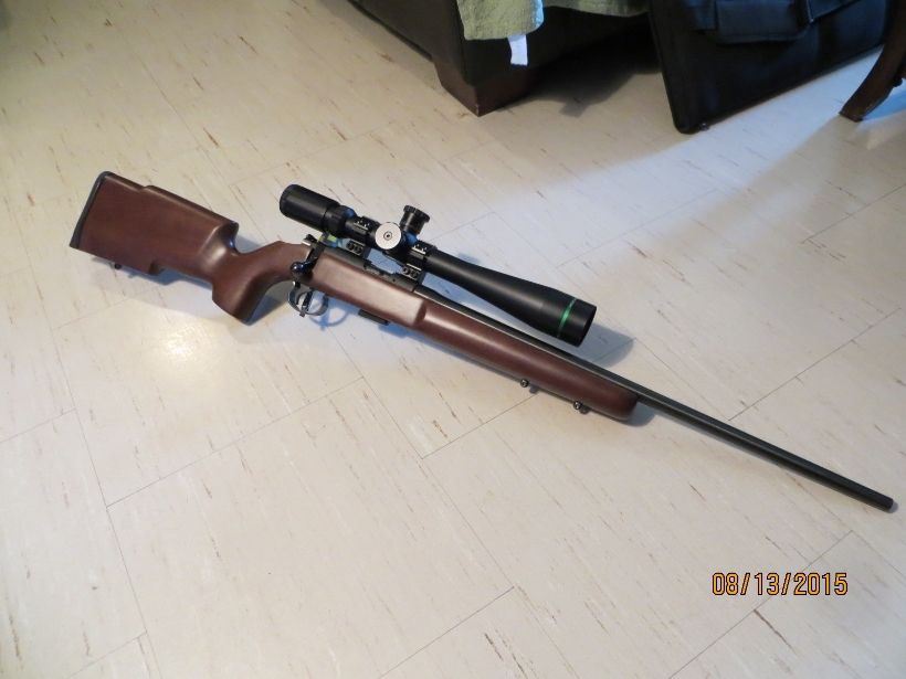

My Boyds Pro Varmint walnut stock arrived today. It came inletted for a 452 Varmint. I inletted for American's tang lug. Tomorrow I'll see how it goes at the range. I've been looking forward to trying this rifle with this stock as it has a wider forearm. I'm undecided about what scope will be more permanently with the rifle.

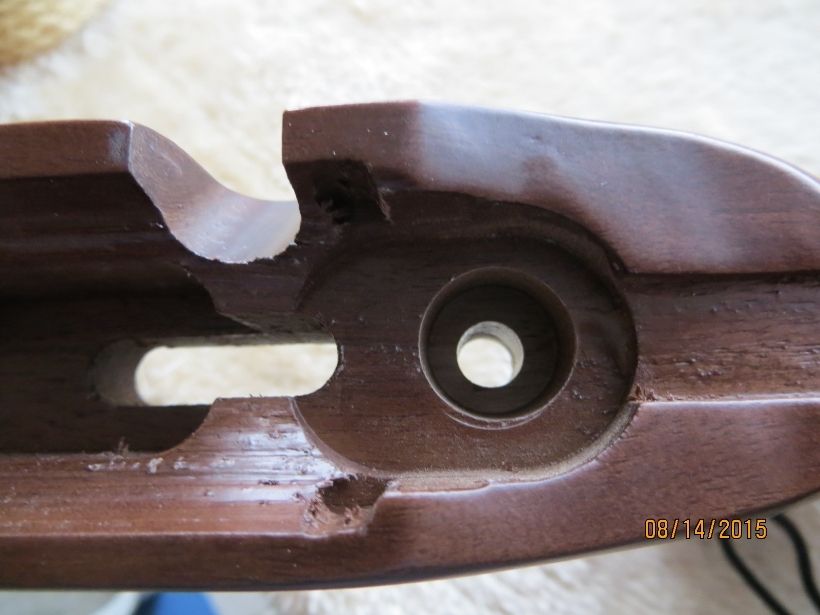

For the tang lug inletting on this 452 Varmint Pro Varmint stock, I used a drill press. First a 1/8" guide hole was drilled through the wood screw hole at the back end of the trigger guard. Then a 5/16" hole was drilled for the rear action screw of the 452 American, using a Brad-Point bit. I didn't put it all the way through so that the guide hole could be used for the 5/8" hole for the tang lug drilled with a Forstner bit from the top side of the stock.
...And the barrel lug screw repair...
The barrel lug screw repair will be made some time in the future. It can be done relatively simply by cutting a plug from walnut with a plug cutter bit. A bit of refinishing follows.

Although yesterday, before the stock arrived, I had told my wife that I wouldn't go shooting a fourth time this week, I found that resistance was futile and took the rifle to the range this morning. I must say that this stock lends itself to shooting off a rest much better than the American stock. I was able to shoot eight out of ten five-shot groups that were under half-an-inch at 50 yards (actually closer to 60, but that's another story). That may not seem impressive to those who regularly shoot very well, but for me it was quite satisfying. I'm now giving serious thought to getting a Pro Varmint stock for my 453 Varmint. Although they are only available in black at this time, they can be had specifically made for that model.

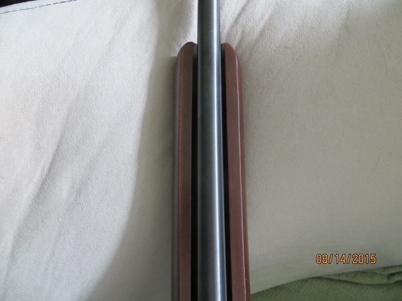

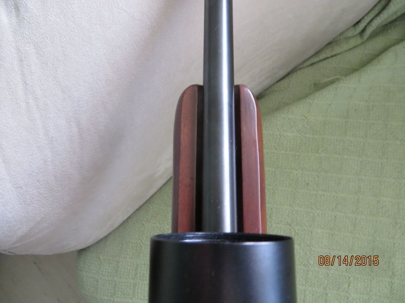

A couple of casual observation for comment for consideration. Straighten me out if this is all off base. Maybe this stock is optimized for bipod & varmint mode as opposed to off the bags?
First is that a stock for the shooting range would better without sling studs to grab on the rests.
Second the bottom of the butt stock should be parallel to the bore. It is now ever so slightly angled.

Thanks for taking the time to take and post the pics. Looks nice and you're off to a good start with a nice clean job on the inletting you did for the rear action lug.
