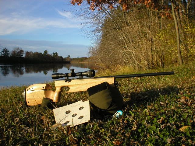

Stock came from Denny very well packaged and indeed nicer than I can capture in pictures. Fit and finish is superb, any after market stock may require a little work to fit the action and this was no exception. The slightest bit of woodwork was needed for a perfect fit very simple task that anyone could accomplish. Trigger guard needed some filing to clear the magazine release, again no skill level required to complete the task.
Besides the action the entire rig is from Denny. BRNO Match Sights, Walnut Box, Single Load BRNO magazine and of course Competition Stock.
The rifle is very well balanced, I honestly wouldnt add and ounce of weight to the front or rear it is just perfect. Standing off hand at 50 yards I can easily hit a 3.5 inch spinner nearly everytime out of 50 shots. The three shots I did miss I blamed more the target than the rifle or myself, the spinner was painted silver and blended into the dirt background.
On the bench it is leaps and bounds over the standard Lux stock. The wider forearm keeps it stable and the cut out on the butt stock sits very well on a bag. My only range test was at 25 yards in windy conditions, not one hole but one enlarged hole with Blazer Ammo. The rifle before the stock change would shoot inside 1 MOA at 50 yards with peeps and Im sure that average will improve with the more stable Competition Stock. The accessory rail is cool to have and I will probably put a bipod on it thats made specifically for this type of system.

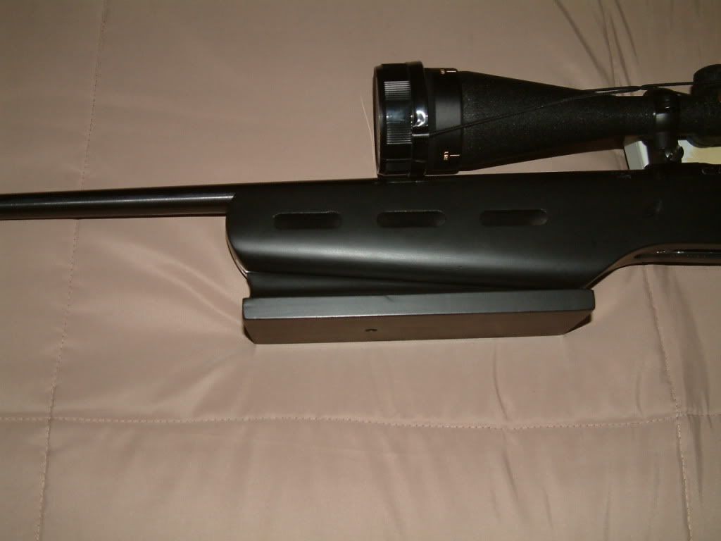

Bench Rest Attachmebts
Gary C

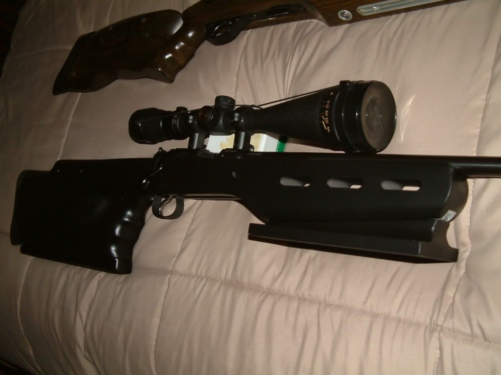

I Modified a Denny Sport Stock and made Front and Rear Attachments to be used for Bench Rest Activities for my CZ 455. I wanted a Stock that I could use in multiple events. I think I accomplished that with this stock.

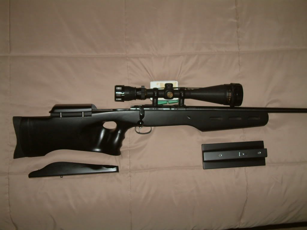

In the First Picture, you'll see a t-slot nut in between two stainless hex head screws that fits into the Accessory Rail. The width of the Base is Three Inches.

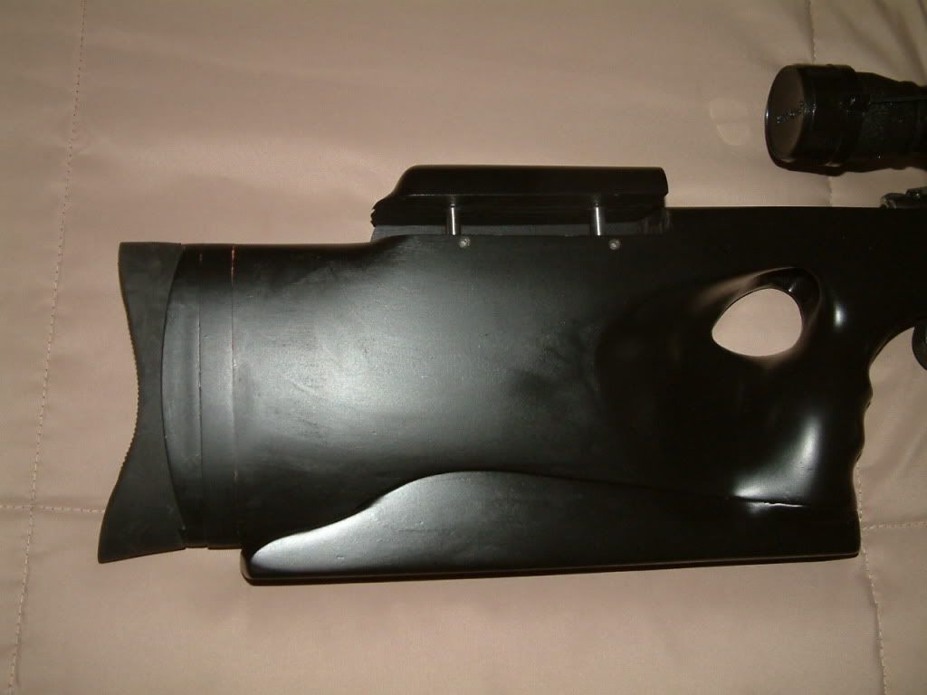

On the bottom of the Rear Attachment you'll see the attachment screw. On top of the attachment there are two alignment pins that fit into receptacles that are imbedded into the stock for Bench Rest

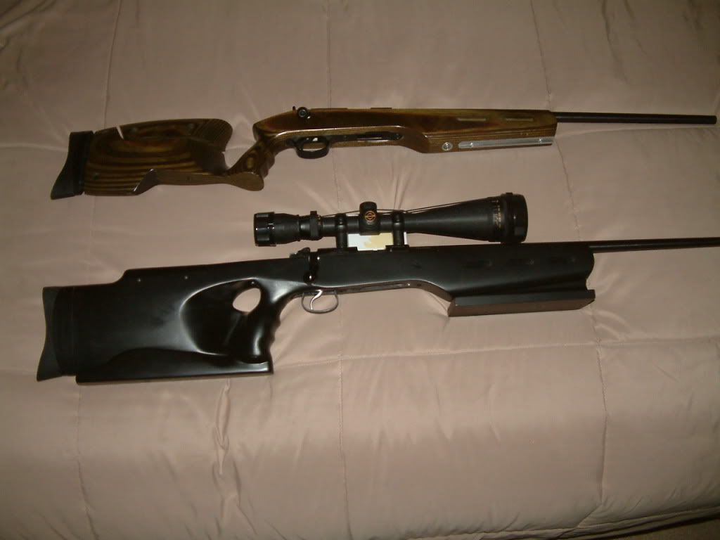

This Picture shows both BR Attachments installed and the stock is ready for Bench Rest Competition. The Top RIG is my CZ 452 in a Denny Sport Stock.

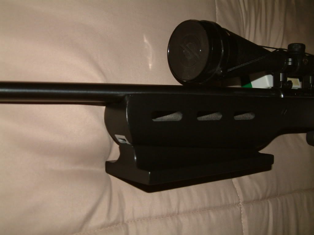

Here is a shot of the Front BR Attachment Installed. The hole is for the attachment screw.
Here is another shot of the Front BR Attachment Installed.

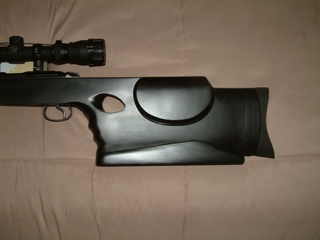

Here is a shot showing the Rear BR Attachment installed and the Cheek Piece.
Finally, a shot of the Rear BR Attachment in place and the back side of the Extended Cheek Piece.
I hope this helps and answers your question.
