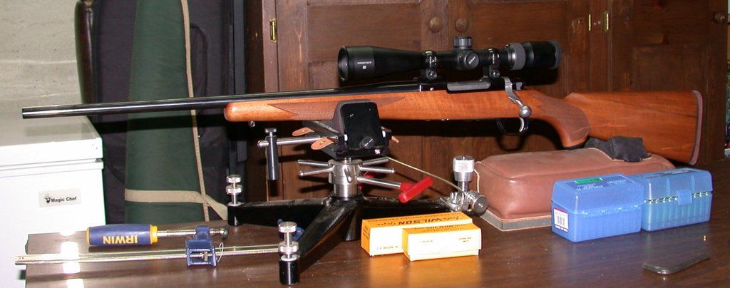

If you want to go that way, there is also my lefty Ruger M77 Hawkeye in 204 Ruger. It will shoot under an inch at 200 yards. Several ammunition manufacturers make 204 Ruger. So, you do not need to reload. However, it is easy to load 204 Ruger. Bullets, primers, brass and powder are all readily available if you do.
I am a bit surprised more shooters are not trying 204 Ruger. It is an excellent flat shooting small bore centerfire cartridge. It will readily take down varmints as big as coyotes at very long ranges. As biologicole says, it has little recoil, so you can shoot it all day without sore shoulder syndrome. It is a 222 Remington Magnum case necked down to take a 20 cal. bullet. That means you have plenty of powder to send a 32-45 grain bullet down range with serious varmint killing energy left when it gets there.

I have owned several rifles capable of 1/2 MOA at 200 yards, including a Ruger No. 1 Varmint in 220 Swift and the Ruger M77 Hawkeye in 204 Ruger pictured above. Each of those rifles needed my home made loads and a lot of load testing to dial in such accuracy.
I bought the Ruger No. 1 Varmint in 220 Swift used from Gunbroker.com for $1100 and the Hawkeye in 204 Ruger NIB from a company that specializes in left handed rifles for about $800. Neither rifle needed major customization, in fact I have done nothing to the Hawkeye, other than load testing.
