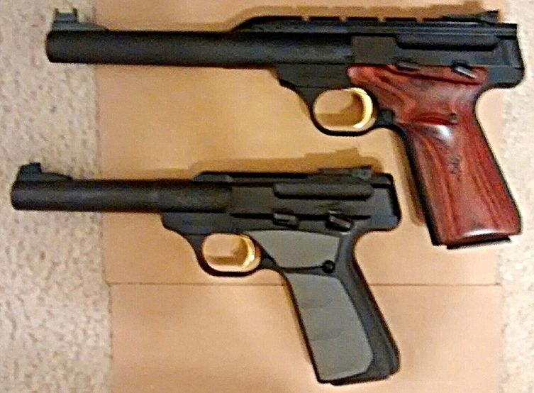

Which grips fit which Browning Buckmark? I just purchased a Browning Buckmark UFX with the grey and black rubber grips. I would like to replace them with something in wood that looks a little richer. The problem is there are several different versions of this pistol, and I don't want to end up purchasing the wrong ones that don't fit my model. There are early and late model frames. Finger grooves, and no finger groove frames, etc.
Can anyone who has experience with these pistols, point me in the right direction? I'd like something in a smooth Cocobolo with a thumb rest. Also, are these things as easy to change out as they look, or is there something I don't know about? As always, sometimes the simple jobs turn out to be not so simple. Thanks in advance.
As I mentioned above, another thing you have to be careful of are the grip screws. My UFX Camper Model has grip screw countersink diameters of 5/16" (.312 dia.). That is too large of a head diameter to fit most of the wood replacement grips. Which means you have to have different screws in order to make the grips work. Browning sure has made this difficult compared to the Ruger Mk. II or III.
there are no aftermarket grips that will fit these, or at least none that I can FIND. I like the URX factory rubber grips, some nice good looking checkered wood ones would be great. I wonder WHY browning designed the strange grip frame this way??!!
Just to be clear. This is the exact model Buckmark that I have. And I have no idea why Browning designed this gun this way, with so many different grip frames. It's ridiculous!

Correct. Those for the UDX finger groove frames are marked as such, and obviously will fit those frames. As Waterking mentioned, this is a bad case of suppliers not knowing what they have. Or what fits what. It all but assures you the purchaser of getting the wrong grips. Then you're forced to deal with a return situation. I wish these people knew what they were selling. Of course none of this would be necessary if Browning would have built this gun around one single grip frame instead of 3+. I've been researching this for days now, and even I'm not sure how many grip frames total the Buckmark encompasses.
#34 ·
In continuing to investigate the Browning Buckmark grip fiasco, I found this out. I'm looking for any experienced Buckmark owners / shooters to verify. Grant you this information comes from Wikipedia, which is why I would like to verify it.
https://en.wikipedia.org/wiki/Browning_Buck_Mark
According to it, the Browning Buckmark comes in 3 frame sizes. UDX, URX, and UFX. According to their chart, both the Camper and the Hunter models have UFX frames. If this is true the factory Cocobolo grips that come standard on the Hunter model should bolt right up to the Camper UFX, no?
If this is the case, all I have to do is order a set of Browning factory Hunter Cocobolo grips and call it a day. But as I say I'm looking to verify this. I could try to switch them out, but I would rather find out for sure before I start getting out tools.
