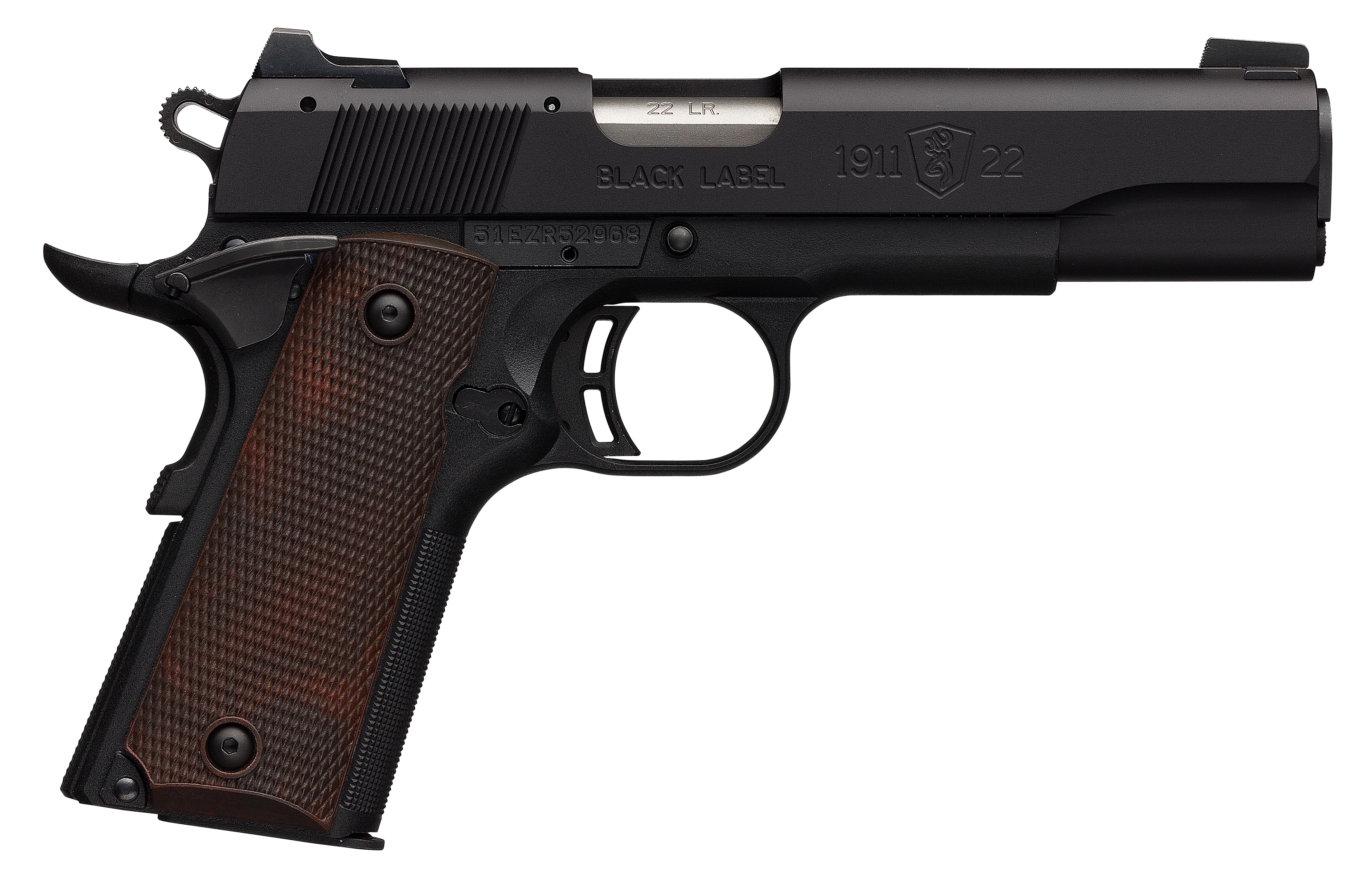

I preordered one of the SHOT Show special Browning 1911-22s several months ago, and it finally arrived. I just got back from putting 200 flawless rounds through it. Zero malfunctions, acceptable trigger and decent accuracy. I shot 100 rounds each CCI Mini-Mag 36g HPs and Mini-Mag 40g RN.
This model has the much larger three dot sights like the 1911-380 instead of the tiny sights that came on the original 1911-22:
The gun shoots quite high, something I've seen mentioned elsewhere on the web. Has anyone seen aftermarket replacement sights for these, preferably adjustable? I'm also going to try different loadings to see if I can find one that shoots closer to POA.
