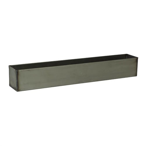

I'm in need of ideas for a rust blueing boil the barrel tank. Heard about the section of house gutter, that seems too flimsy. Is it?
Pipe section with caps and a cutaway might work, but it'd want to roll.
Thought about maybe a rocker panel cover from a big truck or locomotive engine, but haven't found it yet. I need it on the cheap. Brownells has them for about 140. I have a sheet of 1/8" steel that would be dandy, but my acquaintance at the steel shop wanted hundred bucks just to cut it and bend it for me. I dunno how I could make the bends myself. I'd be fine with silicone caulking the ends in it, because I don't have a welder.

I have a bluing tank
made of relatively heavy metal that I purchased from Miday several years ago that I never got around to using. It may need a little cleaning on the inside from a little rust. It's yours for free if you want it. PM me if interested.
Oh my! PM sent!
See? What an awesome place this is! Thanks, y'all!
