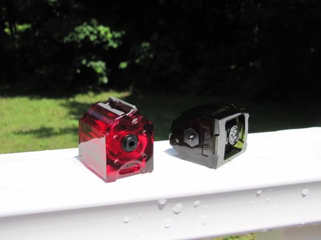

Flattering to see my pic appear (that initial pic in the first post is mine actually) somewhere. LoL I've done a bunch and will do more sometime soon - got a couple ideas I wanna try with this dying thing. Ya MUST get them 110% free of any oils and clean, clean, clean. I use brake cleaner and let air dry and then use paper towel to carry no no oils from fingers get on the surfaces. Get the solution right and 12 minutes later it's done. letting ten sit more than 12 minutes doesn't add any deeper color. It's at max saturation in those first 10-12 minutes. What ya gotta be 100% sure of is the color is exactly what you ant BEFORE putting the magazine body in the solution. Once it's in, you can't redo it and change color. This is why ya gotta check as the color you think you're making isn't always what you're getting. ex: "denim" results in a purple hue.
Oh, boiling water is what you want then you remove from heat. the color isn't a surface coating, it permeates the material.
I've made red, range, yellow, 2 different blues, green and purple. Gotta do some brown (tan) and black next. Each build get a couple color matched to it so that it's specific to that build.

Had some stock to do in the gun room so checked the Rit box. Going on memory on a couple but here's what I've used thus far.
In the pictures in my quoted post here on this thread…
Scarlet gave me the red mag.
Tangerine gave me orange.
Lemon Yellow gave me yellow
Denim gave me purple
Royal Blue gave the lighter blue.
Navy gave the regular blue.
Dark Green gave the green.
I have black and tan yet to try.
All done with the Rit powder and no Simple Green. :)
