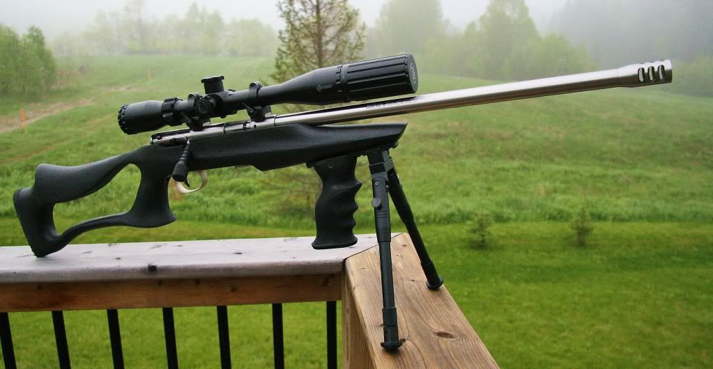

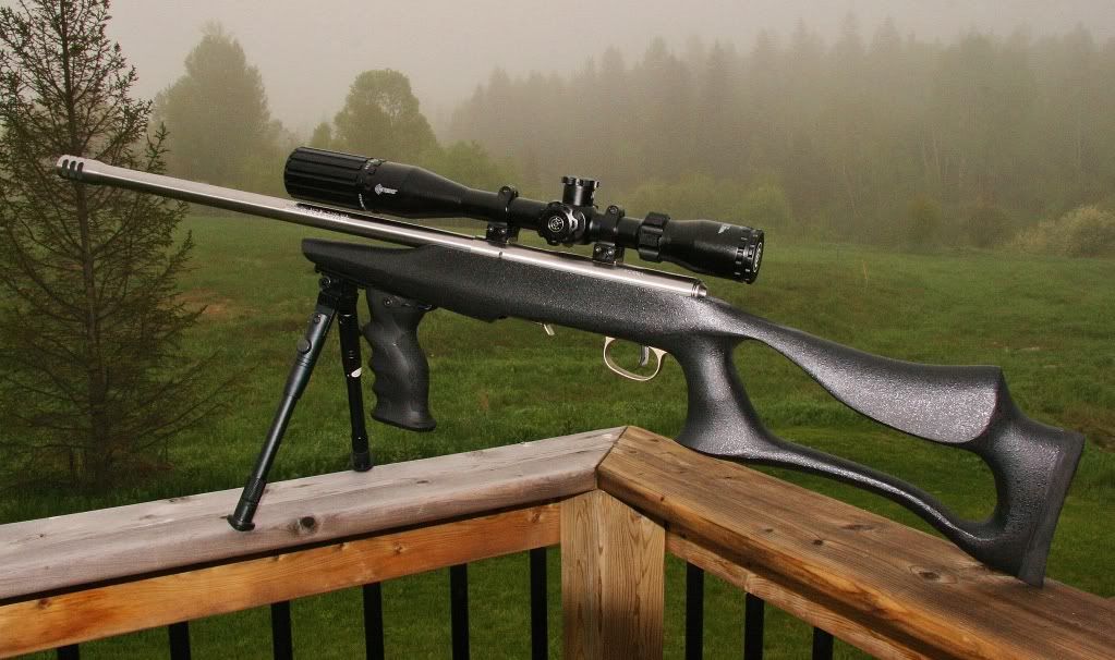

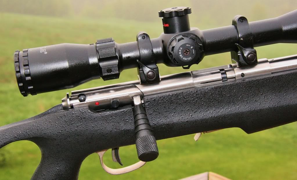

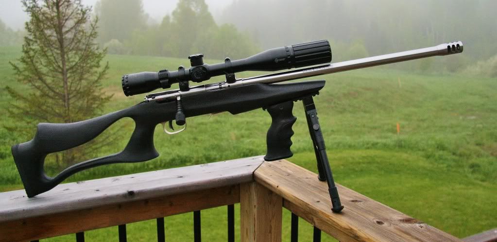

I thought that folks might enjoy a different kind of Tactical look for the 93R17. Most Tacticals are stock TR's or Boyd's Tacticool versions... we tried something a little different...
You Like?????
These guns (we have two; son and I) began life as the standard FVSS models. Here is what we did;
- DIY Trigger jobs
- Savage Gunsmithing 1/8" stainless bottom metal
- Savage stainless inlet trigger guard and long action bolts
- Barrels cut to 18" / crowned / threaded to 1/2" X 28 TPI
- Ross Schuler muzzle brakes mounted and timed
- Boyd's SS Evolution stocks in black textured finish
- Bolt handles ground and threaded to 5/16" X 24 TPI
- Liberty Tactical Bolt knobs
- Dlask Picatinny half-rail mounted with three 1" (#10 X 32) stainless screws (black high-shear epoxy)
- Leapers UTG Bipods (9-13") and New Gen Tactical foregrip
- BSA Contender 6-24X40mm mildot scope
- Durasight Z2 QD rings
- Still in transit (DIP Savage one-piece scope base)
- :bthumb: :D :AR15firin

Bipod mount
The bipod and foregrip are mounted to a Dlask picatinny half-rail.... any picatinny rail will do... I used three 1" (#10 X32) stainless screws into predrilled holes... seated the rail in black high-shear (golf shaft) epoxy... put a dab on each screw... wiped away the excess epoxy as it seated... it is a permanent mount... the stock will come apart before the rail seperates! :bthumb:
