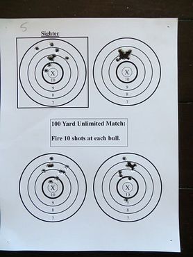

I shot this target this morning. First a half box of Pistol King, then a half box of Center-X followed by a half box of the Rifle Match in question to make sure it's not me, the weather or the rifle. For this test I used my Bergara B14R with the HMR stock, 18" factory barrel with the only changes being the Trigger Tech diamond trigger and the Cortina firing pin shroud and an HD Mask Suppressor. This was shot at 50 yards with a 7-10 mph wind coming from about a 30 degree angle behind me.
This is also from a cold bore which seems to be getting better as the rifle gets more rounds down it ( about 30,000 now). As you can see it did IMHO good with both the Center-x and Pistol King but fell apart with the Rifle match.

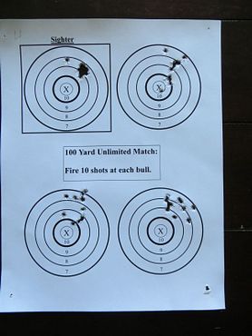

Below are some ten-shot group targets at 100 using that lot from a few years ago. These were shot two days apart in October 2021.
