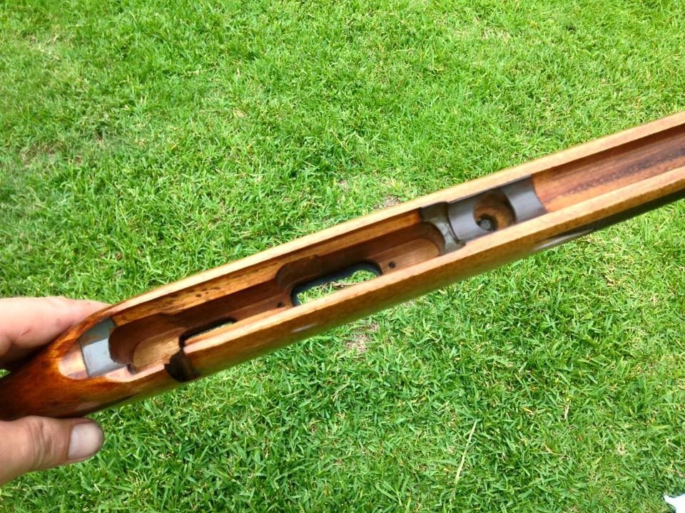

Since getting it home I have given it a freshen up.
Trigger job was the first order and it now is a crisp 2lb ( give or take )with basically no over travel as these rifles had over travel adjustment (in fact its the rifles only trigger adjustment )
Next was glass bedding , I had never bedded a single action screw rifle before, it was a 2 step process as I had to avoid gluing in the action.
A little time consuming but worked well. The barrel now floats from the action screw forward.
I refinished the stock with Tru Oil and Jewelled the bolt for a bit of bling.
Cheap project but a rifle I love and proud to have in the safe.

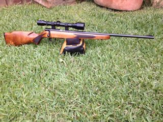

Here are some pics of what she is for your and my enjoyment

Hey John....Long time since I heard from you so pleased to see you're still into the rifle modifying game !!
That's the nicest looking 320 I've seen...An absolute credit to your skills:bthumb:

Mine shoots quite well. With the high end ammo it shot groups with all holes touching. With more practical ammo like federal bulk 525 it shoots very similar to yours.
I think if I put my 6-30 efr leupold on and shoot off a better rest I think it probably has more potential.
Also the old 4 power scope fitted has taken a lot of getting used to as things look so far away for me.
