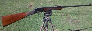

So here it is, it's a W.W. Greener 22 LR Martini, and (I think) a fairly unique and interesting build at that.
First, in reading the BSA website info it's my understanding that the majority of the W.W. Greener Martini's were "conversion" of already built rifles for the British NRA. In many cases Greener over struck the original makers marks and put their own in place of them. That does not appear to be the case on this rifle, the only marks on it are from W.W. Greener.
It does have the Greener single aperature rear sight.
Instead of the standard "globe" front sight it has a "Beech" flip type. One uncovered flat post and one "ball on a post" that is covered. The base of the sight is marked "W.W.C".
Here are some other pictures.
Lots of pics, sorry about that but wanted you all to see it and point out anything interesting or something I missed as I'm no Martini expert!
Here are some of the stats:
1. Looooong skinny barrel! 30 1/4" from muzzle to face of breech bolt.
2. The barrel starts with a relatively heavy contour in chamber area (looks somewhat hexagonal in shape but did not take off forearm to confirm), 1 7/8" in front of action face the round part of the barrel measure .807" in diameter at upper edge of fore arm. From there it is a straight taper to the muzzle where it ends up at .444".
Only one I've seen with this light of a barrel profile. Is this common or considered a hunting/stalking rifle?
3. The action is 1.250" wide
4. Overall length from butt to muzzle is 46.5".
5. Weight on digital postal scale is 7 lbs 4.6 oz
6. Trigger is 5 lb 15 oz using my layman digital trigger gage. Feels lighter than that, not real crisp but not bad.
7. Significantly recessed crown, factory? Assume so.
8. Missing sling loop and screw ahead of the trigger guard, sling eye soldered onto the barrel.
9. As you can see the metal and wood are pretty solid. Very little if any blueing remaining, might be some under forearm but did not look. Even brown/metal patina over all metal surfaces.

This is a very interesting rifle. First impression, a Commercial Greener Martini .303 relined to .22 for Miniature Rifle club. That barrel profile is typical Enfield Martini profile. Then I looked at all the pictures. That barrel does not appear to have been relined, rather it is purpose built .22.
That made me get up out my chair and go to the library and dig the Greener book out. This in it's self is remarkable as I have only moved a portion of my library to Oklahoma from Montana in anticipation of my move at the end of the year and the book made the move.
The book, The Greener Story by Graham Greener does discuss this gun. First glance in the book, it looks like you have a good one.
Greener produced these as the Miniature Service Rifle. Your description and pictures fit Greener's description perfectly. It appears to be an MS 55 grade, meaning 55 Guineas cost. It could be a MS 90 but looking at the stock I have my doubts. The guns were constructed so as the length and weight was equal of a service rifle. I suspect the lesser grade of this bun is because the stock appears to my eye to be a replacement. It just looks very "un-Greener " like. May wrong, but that is OK,
This not a Sharpshooter's Club Rifle as those were .310 caliber and had asmall action.
Oh, yes the cocking indicator is in wrong. When released it should point straight up. Take it out and tun it a 1/4 turn and put it back in.
Records on serial numbers after 22146 have been lost. 22146 is reported in 1909.
So , Yes you found a good one.

Interesting Rifle built on a Large frame Action The foresight is a correct Greener the Mark is in fact WWG I have one on a Miniature Club.
I agree with DD except for the Price suggested 55 Guineas you could probably have bought a small house in those days as a Miniature club was only 3 Pounds or so.
I have a .303 marked as is that one as a short Rifle Military pattern stock and furniture probably made for use by the reserve /Territorial units of the day which shoots Very well I have had some wins at Bisley in Single shot military Rifle Comps.
I also have a Large Frame conversion to .22 by Greener for the Society of Miniature Rifle Clubs (SMRC) both are Pre WW1. I do not see any reason why a Relined one would not shoot very well indeed as do All Martini action with a decent non corroded bore.
