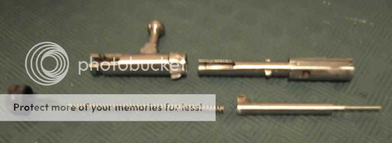

On the subject of the Ural 3 lug bolt...................
Not wishing to hijack 1srelluc's thread, but this is relevant to his new rifle and may be helpful to others in some small way......................
I decided that it was time to give the Typhoon-3's bolt a clean and re-lube today.
Pressed the end cap, turned it and BOING!
Poor photography I know, but the components can be identified.
Cleaned all the component parts inside and out..............lighter fluid being a favourite of mine..............all parts then lightly lubed with Teflon based dry lube and re-assembled.:bthumb:
Peter.:)

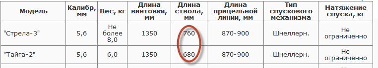

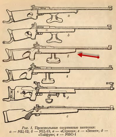

Unfortunately it is NOT a "STRELA" ("ARROW" in English). It is a "TAIGA-2" and it looks much like a "STRELA". Main difference is in barrel length: "STRELA-3" - 760mm, "TAIGA-2" - 680 according to some old sources.
It is from the same type line as Typhon-2 and MU-12 (in my opinion MC-12 should be the most correct abbreviation from Russian). "STRELA" was designed for usage in Olympic Games and high level of International competitions including World Shooting Championships 1966 in Wiesbaden (http://en.wikipedia.org/wiki/1966_ISSF_World_Shooting_Championships). Here is an image from old book where "STRELA" has very identical shape to "TAIGA-2" ( "STRELA" is 3-d from the top):
Congrats !!

Thank you for the info.
To pick your brain just a bit.
About the last rifle in the pic you posted. The LGS I haunt has a couple of blued steel (not painted) Vostoks with the stacked but non-adjustable (verticaly) buttplates.
They look to be better put together than the painted Vostoks. Are they any count?
