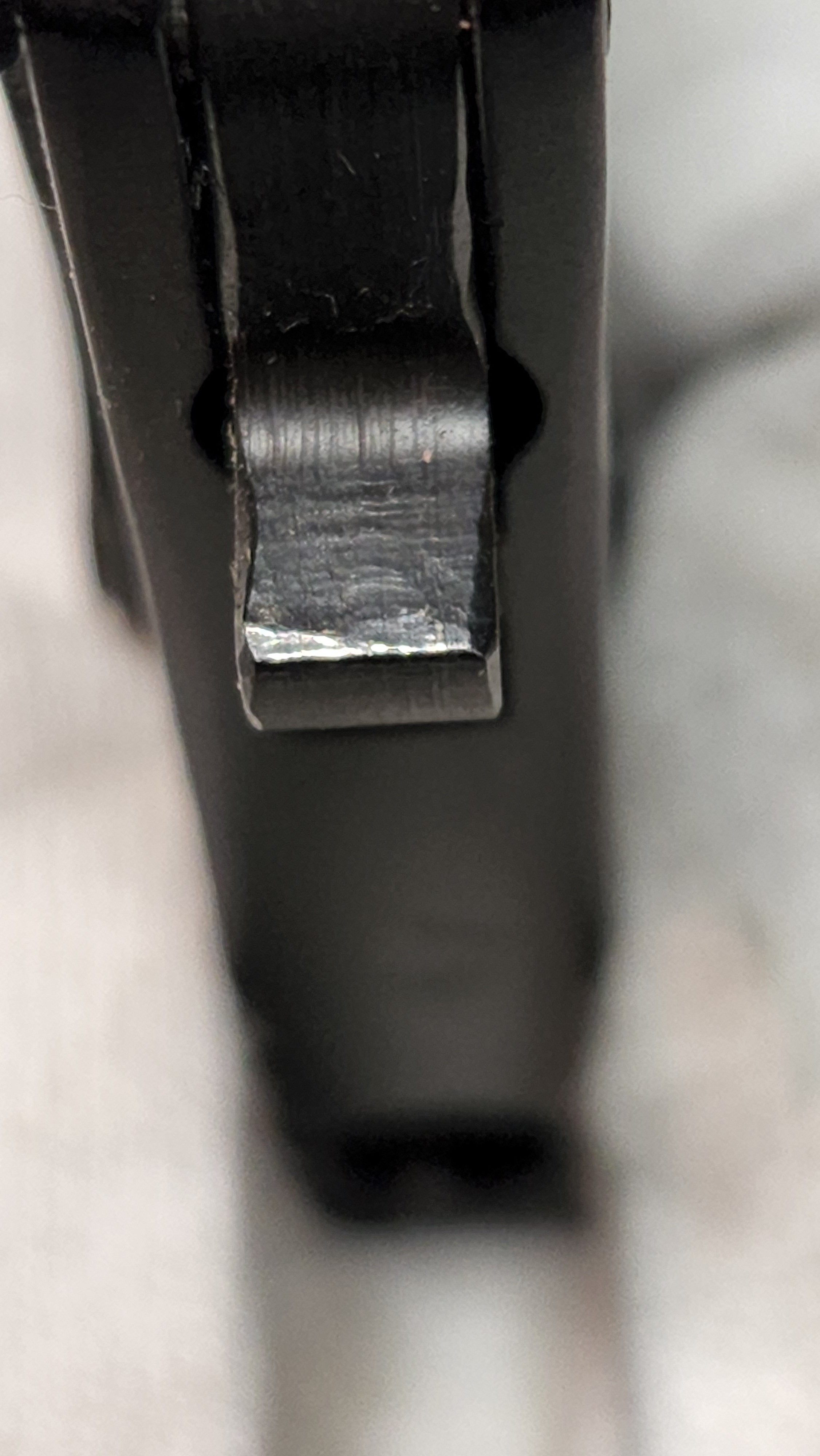

It is creepy but not really how I've always thought of trigger creep. I've had creepy triggers before (and I very much dislike them). This is different. It's very smooth and actually feels pretty good. Just, like I said, kind of mushy. I've tried less sear engagement and it fails to cock if I work the bolt fast. No gut for me not even for benchrest
One thing I don’t see mentioned here is the firing pin and hammer spring and sear contact point on the hammer. All of these have a big impact on trigger weight. Making sure your sear contact on the hammer is perfectly flat and highly polished. Having a spare hammer/firing pin spring to modify a little at a time is a good idea. Just don’t fool with the firing pin return spring if you don’t have to. If you’re not getting your trigger pull down to where you want it this is a good way to get it lower. Just don’t shorten the firing pin/hammer spring too much or you’ll get light primer strikes. Just a little goes a long way. Just have spare springs to work with and leave the original ones unmodified so you have a recourse if it doesn’t work out.
