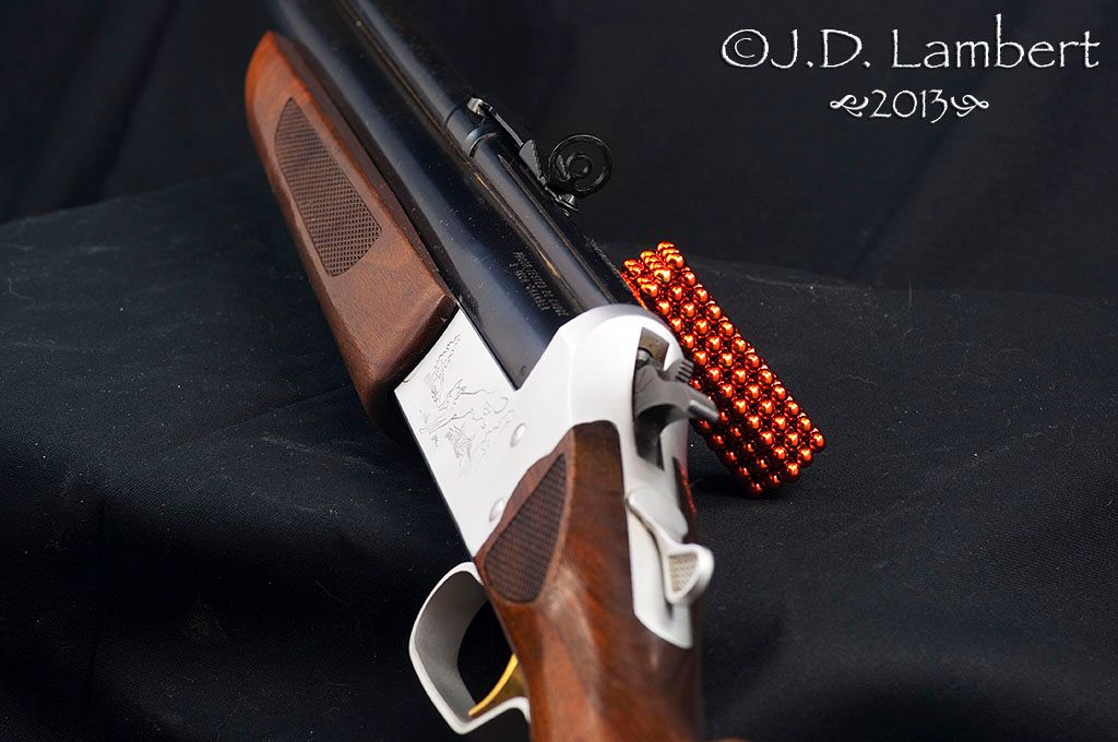

That trigger guard isn't original. Did you put it on there? What material and finish is on it?
#3 · (Edited)
The original trigger guard was cracked. It appeared to be some sort of cheap cast metal. Otherwise the gun was in great shape. I bought a replacement guard (the stamped metal one that's currently on it) and a bunch of spare parts for it from Numrich. I figured it would be a good gun to keep in working order since it's versatile.
A local gunsmith at Oakridge Custom Refinishing installed the trigger guard for me. The guard was black/blued when I got it and they refinished it. It's probably Duracoated; they were a well-known outfit for Duracoating.

I'd error on the cautious side - that looks like a great rifle you have there. Very nice photos! :cool::bthumb:
