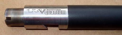

I just completed more testing yesterday by taking a sample out of the inagural batch that went to Shooter's Discount and testing it in order to experience exactly what a new barrel owner will experience.
The very first thing that will be noticed, is that the first shot from a cold barrel, and the first hand loaded shot will land much closer to the next shots on a target. That is one of the benefits of good barrel tensioning of the German made Lothar Walther blanks.
We weighed them at 24 ounces. The actual barrel portion is 16.25", then the threaded adapter and weighted end cap extended the overall length out to about 17.3". Really stinkin' liteweight, but with the weighted nose they balance really well and provide what I call "Pointability", a perfect combination of balance and nose weight for steadiness offhand as well as off of a rested position.
The 416 Stainless shanks are heat treated on the breech end just as the factory barrel is done, and the fit to the receiver is snug as a bug. The laser engraving is also a very nice touch. The extractor groove is done in such a way (specific angle) as to promote a really good grab onto the rim, and the cut itself is right up to the radiused chamber lip. I've used nothing but factory extractors in my testing and had 100% reliable cycling.
The extractor leads into a very nicely installed chamber that is much tighter than a Bentz chamber, a design we've been toying with for several years now. Exceptionally high accuracy but with enhanced reliable cycling of a lot of the less expensive cartridges.
That leads down to one of the tighest 22lr bores found anywhere, with a final twist of 16.4:1. If you take a peek down the bore, you'll see nothing but a perfectly honed and lapped mirror finish underneath of that protective oil film. That meets a chamferred crown before exiting through the compact stainless threaded adapter and out through the stainless end cap.
The aircraft aluminum outer sleeve is a very nice satin velvet black done with a virtually indestructible epoxy powdercoat.
Thank you so much for that excellent report on a great-looking new barrel!!!
Just a question on this. My less-than-professional impression has always been that tighter chambers, while giving greater potential for accuracy, could often lead to LESS reliable feeding and so forth, especially when dealing with lower quality ammo.
Can you describe how it would work with this barrel, that the TIGHTER chamber will actually lead to ENHANCED reliability?

Some suppressor-specific questions:
What is the thought behind the partially-rebated muzzle thread shoulder? It appears that when a suppressor is threaded onto the barrel it's rear face will contact only a small portion of the shoulder concentric to the relief and leave the impression of a gap between the suppressor and the barrel. From my understanding, a wide bearing surface to the shoulder is advantageous. Maybe, I'm just misinterpreting the picture.
Also, what is the thread length?
impression
First, allow me to quench any doubts or concerns by stating that this threaded nose piece was originally designed by my very good friend who is incredibly gifted in many ways. He is also one of the Authors of "The encyclopedia of Glock, a complete reference guide". He was the one who originally offered up the solution to utilize His existing design as the needed solution both for barrel tensioning nut and threaded nose. Consequently, this piece has been in use in the field on pistols for more than several years now. Walthers, S&W's, Glocks, yadda, yadda, yadda. I can't even keep up with all of the applications he now covers. So any reservations about it working or not have already been addressed by the many thousands of similar adapters out in the field. Besides, Ted Nugent uses them on His guns, that's good enough for me.:)
The important thing here is that the suppressor is within tolerance when installed so that you do not get a baffle strike, and it is a very valid concern. This HAS been a problem recently for several well known manufacturers. We spent a lot of time getting all of that correct, testing it and verifying function/clearance/fit.
You all need to thank Bob for all of his knowledge and experience
being first offered, then poured into this project. For those aspects, it has been He that ensured that the answer is everything it needs to be, thread length is the ideal .400 so you don't crash the first baffle.:bthumb:
