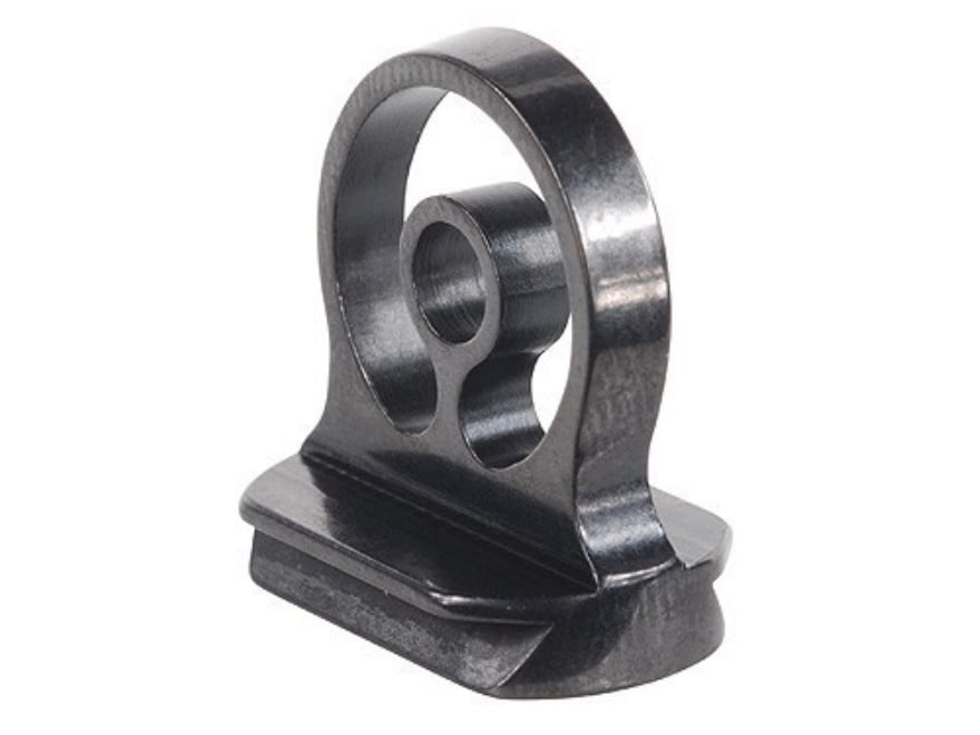

Has anyone found a receiver mounted ghost or aperture sight for this rifle?
Would it need a new front sight as well?
I don't know about an aperture sight set, but I mounted a set of hiviz fiber optic HHVS500 on mine. So far it shoots to point of aim at 25yds. Haven't had an opportunity to test it further yet!
I'd be interested to know of an aperture set that works as well.
Fiber optic may be a good choice.
I also found this fixed ring, just have to figure out what distance I would want,
Then there is this adjustable one but the length and pin dont match,
I will have to do some shooting to understand what I like better.
That's how I mounted a Williams peep sight on this rifle when iI first got this rifle there were no bases available
the odd spacing of the DT on the reciever, dang I tried all sorts of combination bases until I found the Weaver T09 base
it's pretty flat and has 3/8 dove tail groove perfect for this peep sight
