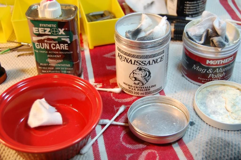

For this purpose,I have,in the past,used either Renaissance Wax (RW) or Eezox on:
SS,
Stripped (formerly blued) steel,
Aluminum
And Pot Metal
Both products work for protection, providing a barrier against rust, corrosion and oxidation

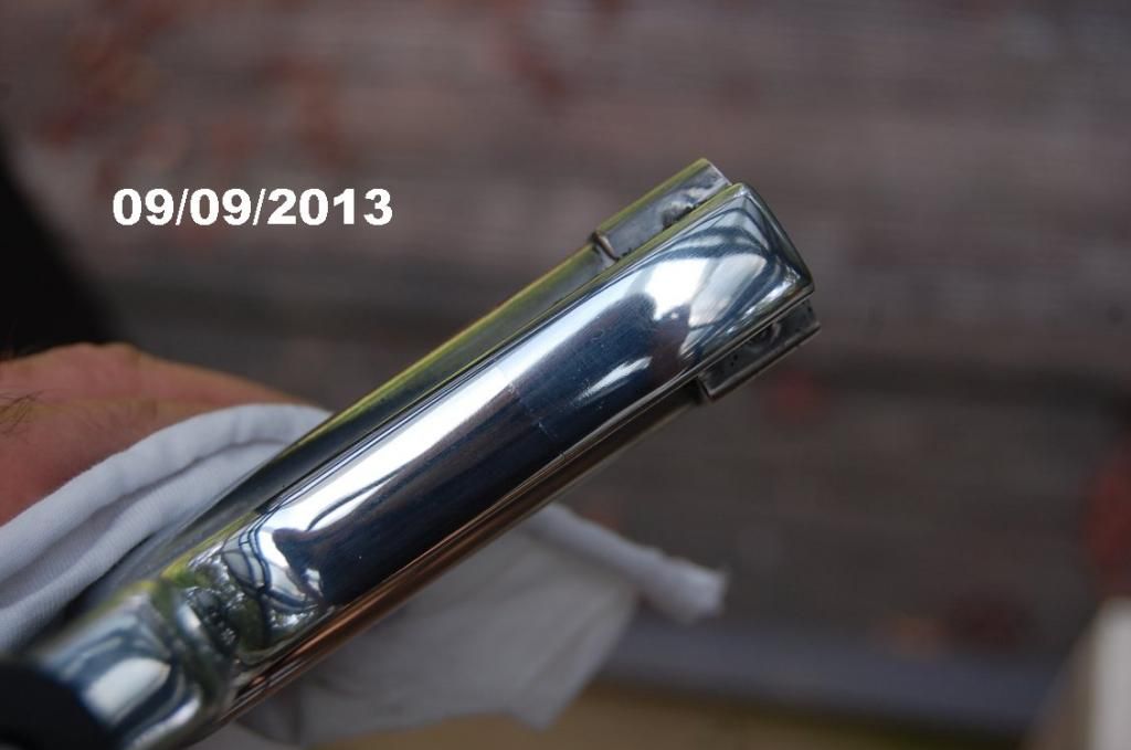

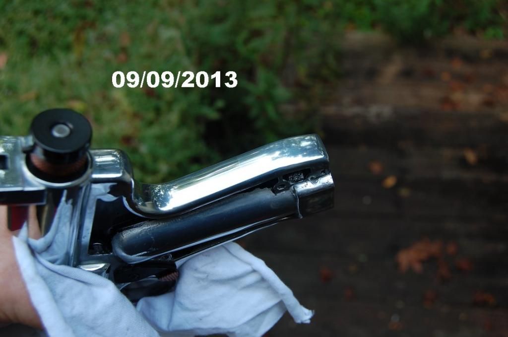

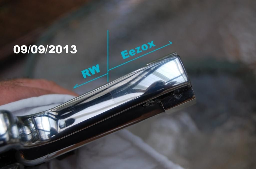

After a fresh polishing with Mothers Mag Wax,RW is applied to the entire backstrap,allowed to dry and then buffed off with a cotton cloth

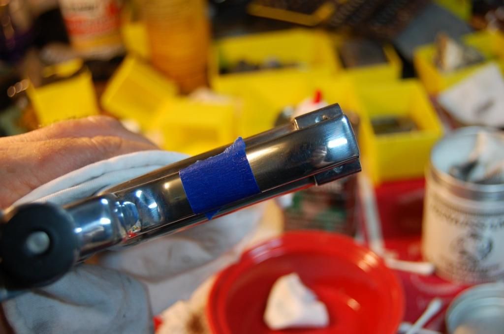

Following that,I applied painter`s tape to isolate approx half the backstrap
On the area to the right in this pic,I wiped off the RW with Eezox….3 times, with clean,dampened patches for each wipe….removed the tape and then let it remain untouched for 24hrs
Fast forward 24hrs….the Eezox is wiped off and buffed with clean cotton cloth….I was careful to wipe away from the still waxed area
To my eye,they both look equal at this point

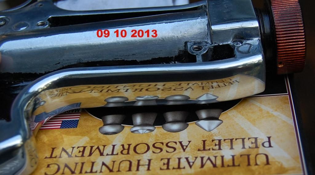

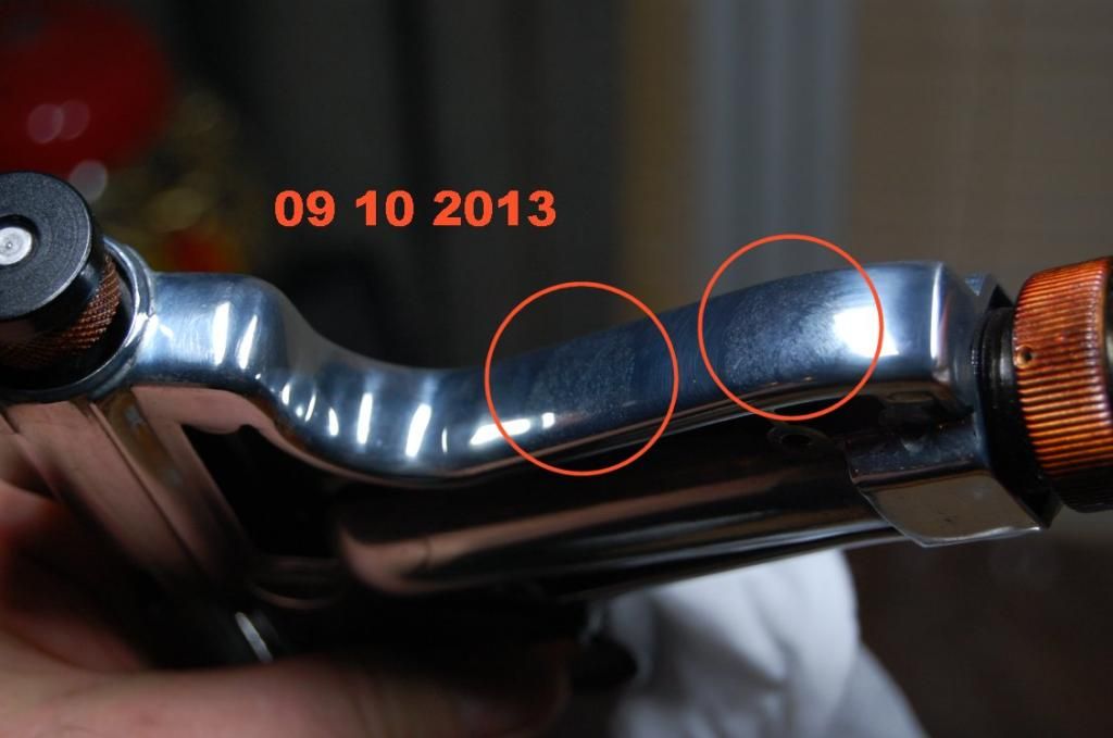

I then pressed 2 fingers onto the backstrap to simulate the effects of typical handling….prior to this,I had not made skin-to-metal contact with the backstrap
and the trial begins...............:D:confused::cool:
I`ll handle (Sweaty Hands :eek:)and shoot this pistol several times over the course of a month...never wipe it down...then update my findings

I charged this pistol with CO2 yesterday, found some leaks
I disassembled/reassembled it several times before I got it air-tight
In the process, the frame was subjected to grease, oil and extensive handling
It was too much of a mess to ignore…..so I wiped the frame down with clean cotton
The back strap seems to be oxidizing at approx equal rates on both target areas.
I'll begin the 1 month, no-wipe, trial again…. and try to be more patient this time….:oops::sad::Blasting_

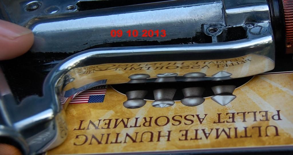

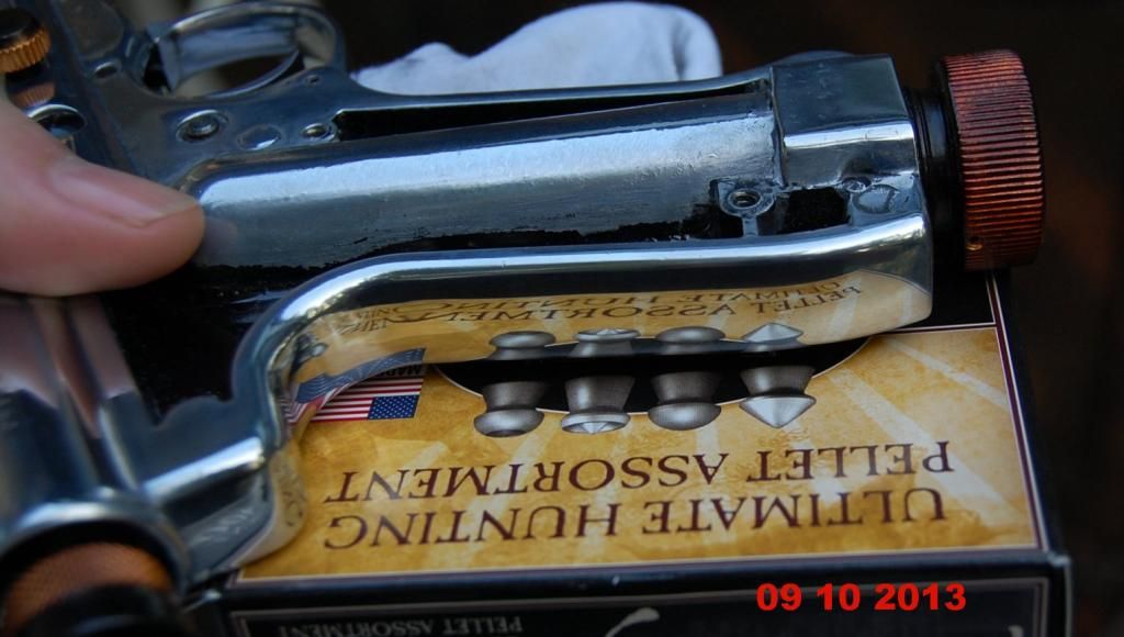

ONE WEEK IN
It`s been a week and a day now....... since this trial has (re)started
This is how the backstrap looks today
And the barrel….as much as possible, I held the same angle, and used the same camera settings on the comparison picture…..shot minutes apart in the same relative position to the natural light source…..on the left, the barrel has been wiped down with my El-cheapo SG silicone pistol sleeve
And…oxidation thru both RW and Eezox / as compared to periodic silicone wipes

From what I can see, there is no discernable difference in the oxidation protection of either product that was applied to the backstrap
Renaissance wax on the top half….Eezox on the bottom half
I have continued to use my silicone wipe on the barrel and it`s holding up well
This thread is turning out to be boring (even to me)…..So, unless something unusual occurs, I won't be making any more updates here
Conclusion: for oxidation protection on pot metal::
My clear choice of technique is MMW, followed by periodic wipes with a silicone impregnated pistol sleeve
