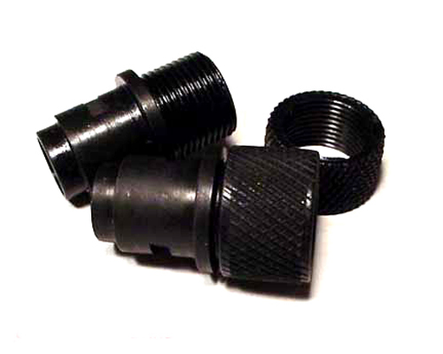

Well I will post my little trick. My Barrel weight screws are red lock tite and I still can get the barrel off for cleaning.
I have an adapter on the barrel, I tighten my fake can and then give it a twist, 9/10 it loosens up, the other time I need the SO's help. The barrel cover and the weight come out as one piece, you can remove the slide and barrel to clean all you want.
It's a bit tricky to reassemble but after you do it once it becomes a breeze. That also allowed me to mount my fiber optic sight on the barrel weight. I saw a really nice 1/2x28 at a gun show that had an external nut and wrench but it was parkerized (sp) and I like mine all black. Still might get one later to make it easier.
wg
I got the thread adapter and it works well. Instead of using red Loctite, I cut notches on the outer thread so I can fit the original wrench to tighten it. I cut the notches using a basic dremel tool, it's not a perfect notch but the thread protector hides it completely anyway.
For the barrel sleeve, I'll be cutting a smaller notch and use that instead of the factory notch. The factory notch is ever so slightly larger than the barrel fin that fits into it, and allows the barrel sleeve to rotate slightly.
