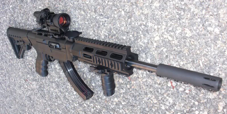

Someone asked when one of us were going to post an official pics thread? Well I just got my threaded 16" stock barrel in today so I guess I will start the "GUN PORN"
I figured it would be fun to have you guys post your builds and also updates when new parts get added. Lord knows mine has been tinkered with like crazy.
Here are the specs...
Donor rifle was a compact model 10/22 (no barrel band)
Archangel kit bought for $150 at a Vegas gun show
Lots of sanding to get it square and level and to get certain parts to fit!!! Uggghhh:mad:
Custom mounted 4" picatinny side rails
Painted the kit flat black
Tango down "stubby" fore grip with quick detach lever
extended mag release
auto bolt release (home job)
Butler creek smoke 25 round "steel lips" mag
Custom 1/2"x28 threaded 16.01" stock taper barrel
reverse slip over bird cage style flash hider (makes the barrel look shorter)
Aimpoint Comp M2 4MOA red-dot "clone" with quick detach lever mount
Superior Concepts jumbo bolt handle (not shown at the moment but I have it)
Parts pending - Power Custom adjustable sear and hammer, and trigger, I'd like to Nemorize the barrel too.

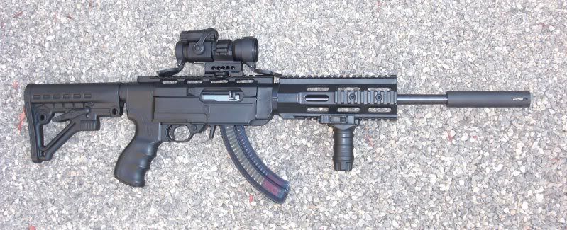

Thanks, here is the setup...
Ruger 10/22 compact model
Archangel kit, painted flat black and the usual sanding to fit perfect! No drooping hand guard on this kit!
stock taper barrel cut from 18" down to 16.01" crowned and threaded 1/2" x28
M16A2 birdcage flash hider
custom mounted 4" picatinny side rails
cheapo laser
Tango Down (clone) stubby fore grip with quick detach lever
Magpul MBUS (clones) - back up iron sights
Aimpont Comp M2 red-dot (clone) with A.R.M.S. (clone) quick detach lever
home made auto bolt release modification
Butler Creek 25 round steel lips "smoke" mag
Archangel extended mag release
(not shown) Superior Concepts oversized bolt handle. Had to dremel off some of the top reciever to fit it on the Archangel kit.
coming soon... Power Custom adjustable sear and hammer, bolt buffer and a PC trigger.
