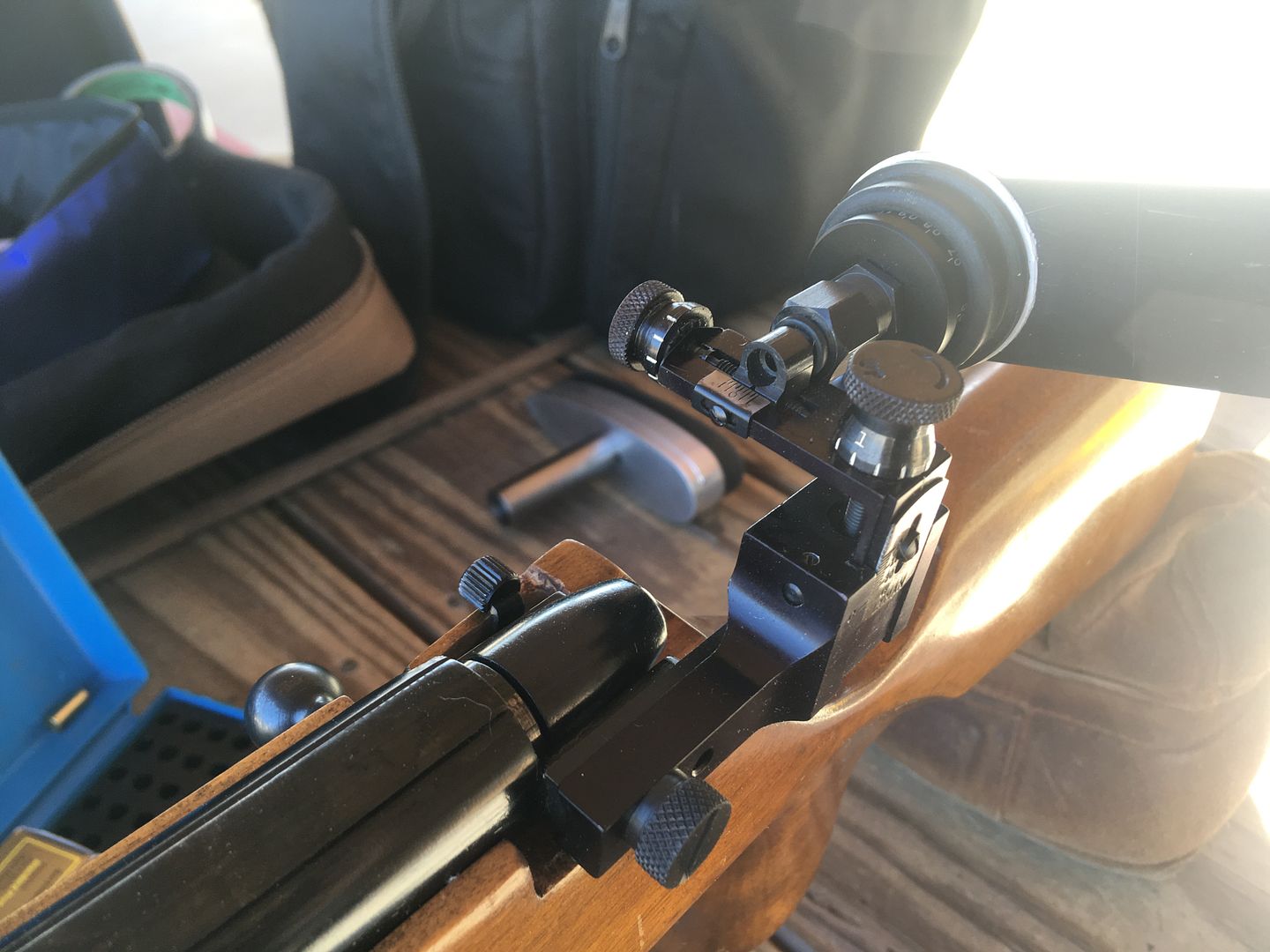

The Lyman sights are old school but I had the same set on my Savage-Anschutz 64 Match, and I like the 90 MJT. With a little tweaking it can be a very good rear sight. I eventually added an adapter to my Annie's 90 MJT to use European rear aperture, and added a small o-ring to remove the slight bit of wobble that is otherwise present in the aperture holder.
I also bowed to the realities of middle aged eyes and replaced the Lyman 93 with an 18mm Gehmann front sight and adjustable aperture to give me a little more flexibility in getting the perfect sight picture. I've played around a bit with 1.5x magnification but I'm not a real fan.
In any event, I screwed in the Gehmann rear aperture from my Annie a put the Gehmann front sight on the 540XR and bore sighted it.

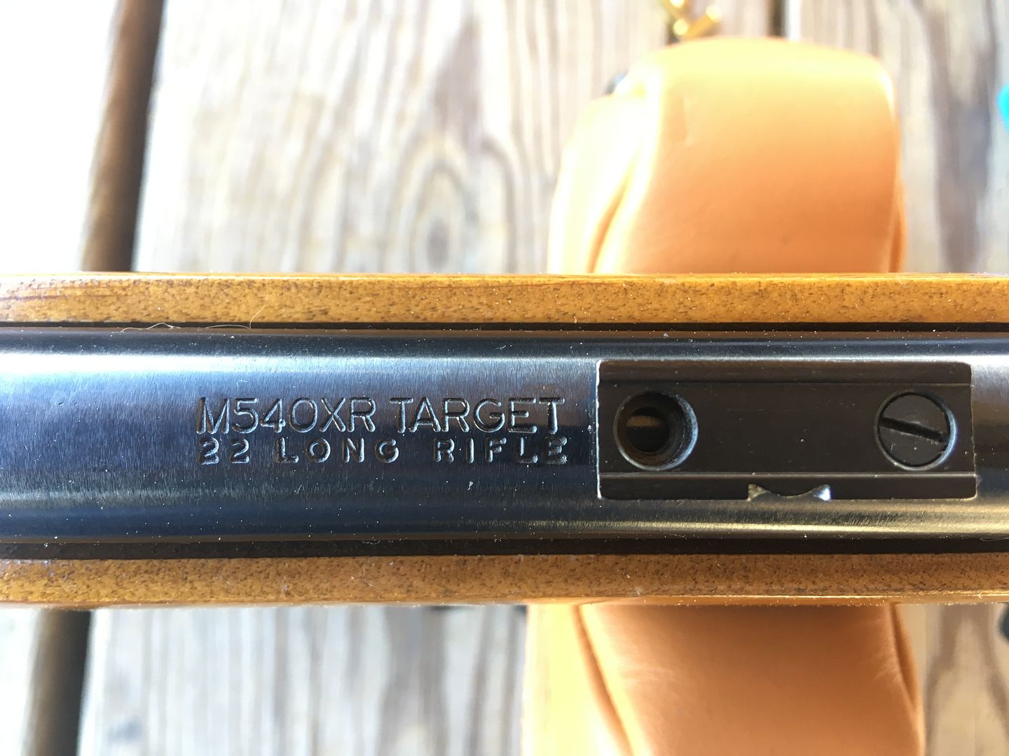

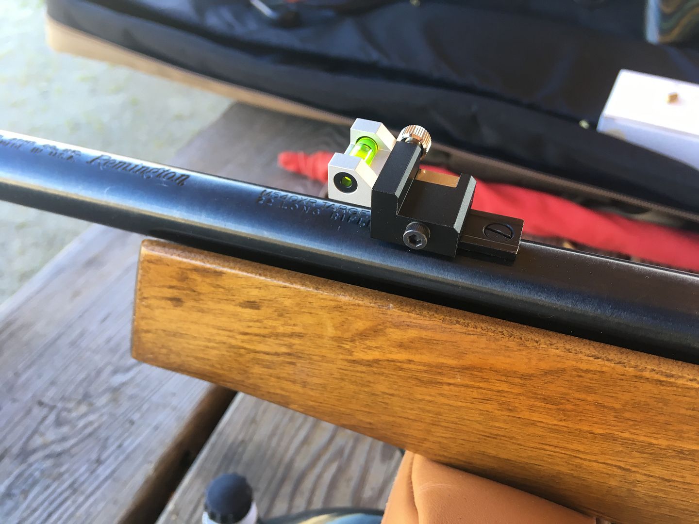

However, I'm not much of a bench rester and what I do is normally with round bottom stocks and the flat bottom of the 540 didn't sit all that well on the bag on my front rest, so I decided to mount a level on it. I use a level on my Annie that is supposed to clamp on the 11mm rail, but I modified it slightly to fit on the forward scope block, where it then appear to sit just under the front sight. I borrowed the rear block off my Annie and moved it to the front position on the 540XR. The screw was the right size as was the curve on the underside of the block, but the hole spacing is different. However, one screw is plenty for this application, at least in the short term.
