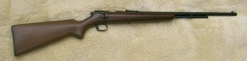

Here's my rifle from which all this started, it's an early non-A with a straight bolt:

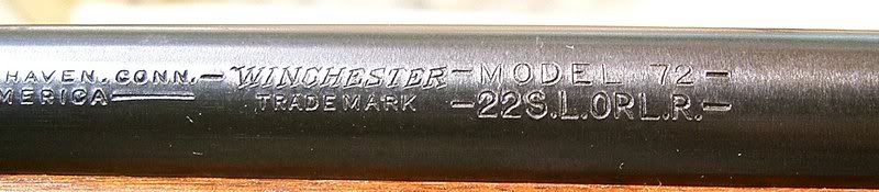

Here is the roll mark of my older 72, followed by my pal's 72 without an A

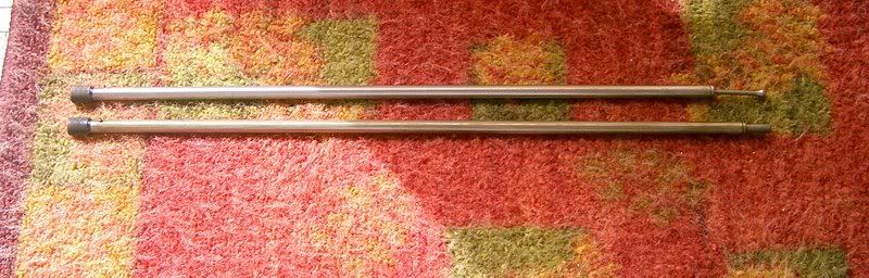

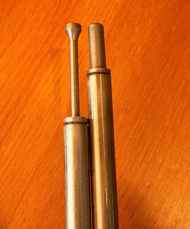

The magazine tubes, same overall length (18 1/2"), different tube and follower lengths-"A" on top
closeup of the two followers, the "A" version on the left

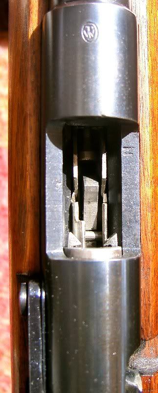

Here is a picture of the fire controls and feed system on my 72. Notice that there is no trigger screw adjustment provision like on the 69A and 75. I will get the "A" version picture when I can, didn't have the chance today. Since the magazine tubes have different lengths, it suggests that the undercarriage of the "A" version should show some design alterations.

BigLarry comes through! Can you verify that your A has the updated parts as above? The follower and magazine tube, the carrier, and anything else that comes to mind. I would really like to see what the undercarriage parts inside the stock look like if I can ask you to do that sometime. You are a good photographer I see, put those skills to good use! :p

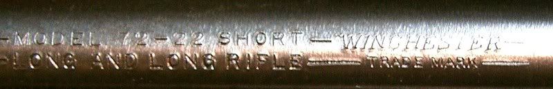

this is a pic of my older guns roll stamp

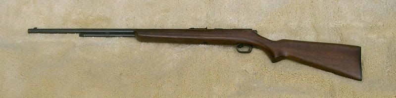

This is the newer gun
This is the two side by side to show the bolt style

4.Inner magazine tube old style or new, with different followers

The magazine follower is the solid type. like the one on the right from page one of this post. The trigger is smooth and has no groves.
