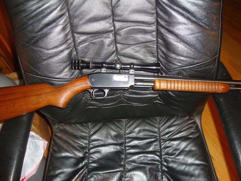

I have 221,353 Why is does the list sip over this period? Also does anyone know where the best place/site to sale on would be?:confused:
Hello,
Your rifle was manufactured during 1955. What list are you referring to that skips over that period? Is your rifle chambered for .22 short, long, and long rifle? Try listing the rifle along with several good, focussed detail photos on Gunbroker.com
Michael
