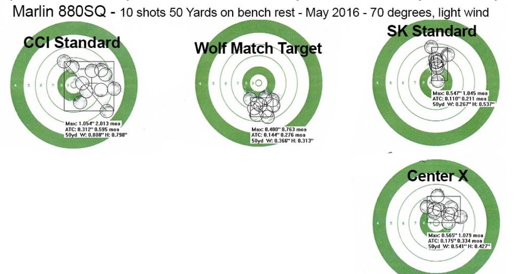

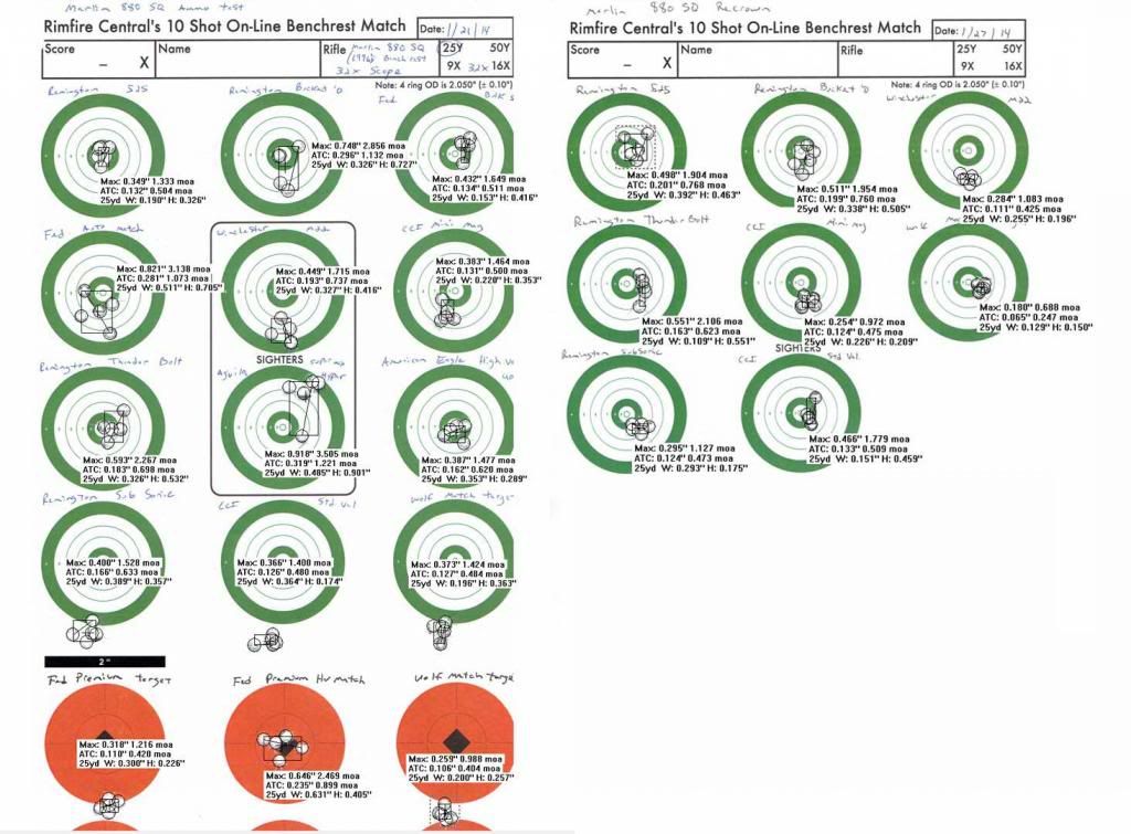

Mine is a 1996 model with the semi match chamber which I bought used in 1997. Using standard velocity, wax lubed 40 grain ammo, CCI SV, Eley Target, etc. it will put five shots in under a half inch at 50 yards all day. I finally added a Rifle Basix trigger this past week and can't wait to hit the range again. Even with the stiff factory trigger, this rifle out shot my CZ-452, Remington 541T, Remington 521T Jr ScoreMaster, Browning T-Bolt and a couple other, all of which have been sold or traded. My 81TS is nearly as accurate, though it favors high velocity ammo.
I bought mine back in 2000 or 2001. At the time it was about $220, which was pretty pricey for a 22 unless you were buying a Ruger or CZ.
I put a Rifle Basix trigger in it (which is a must) and a Simmons 22mag 3-9x32. Dynapoints tend to shoot about 3/4-1" at 50 yards. Minimags solids will do 1/2-3/4". You can kick a shotgun shell at 50 every time with no effort.
1/2" groups are a dime a dozen online (and for frequent shooters with highly modified or pricey factory guns and pricey ammo they probably get that), but the 880sq shoots great real world groups for the casual shooter. :bthumb:
