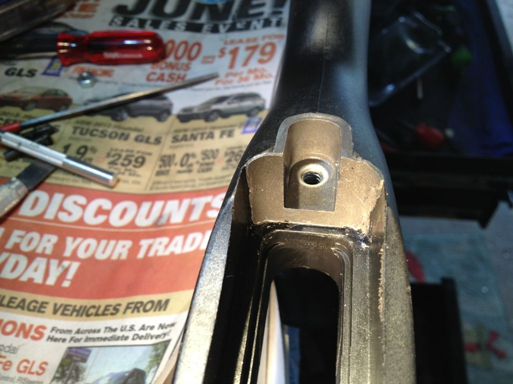

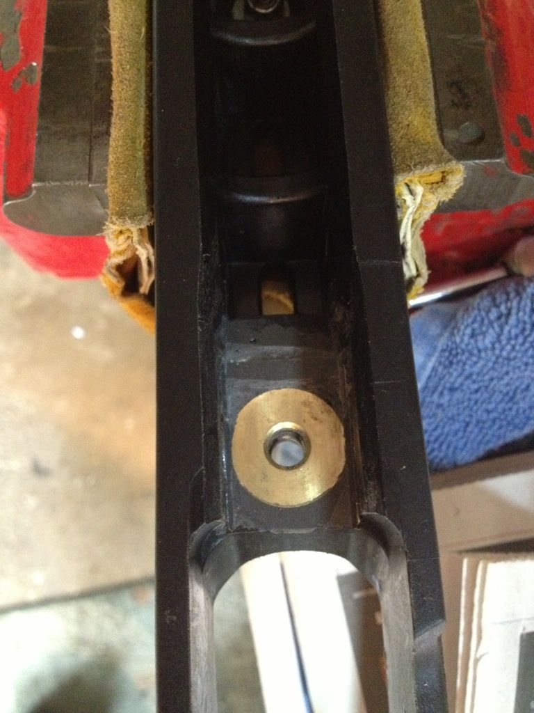

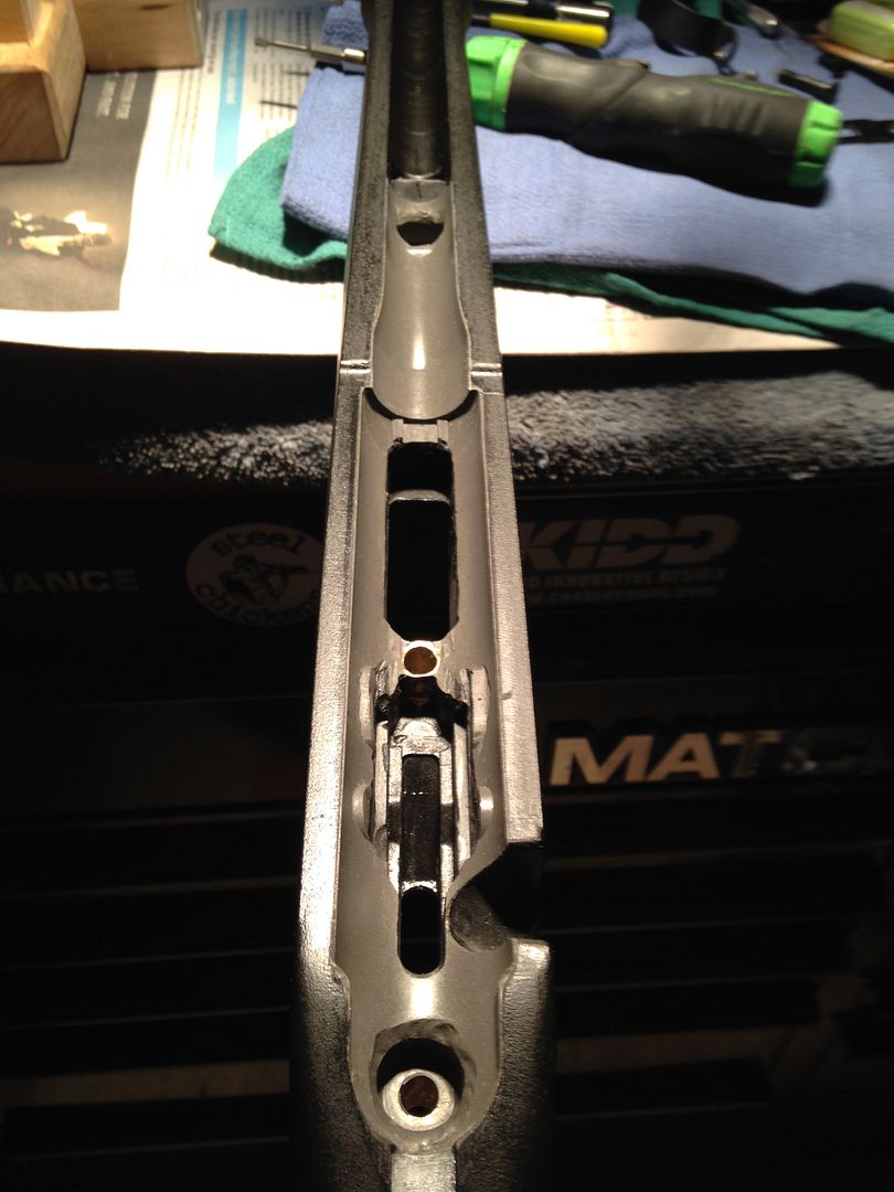

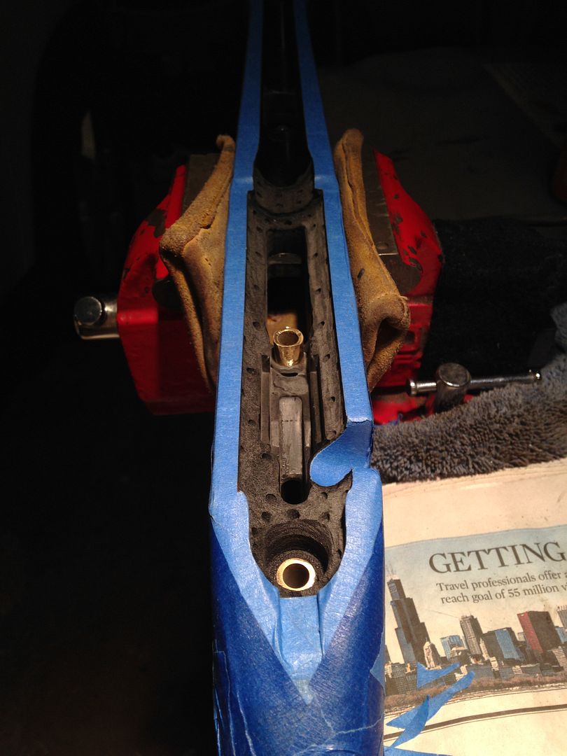

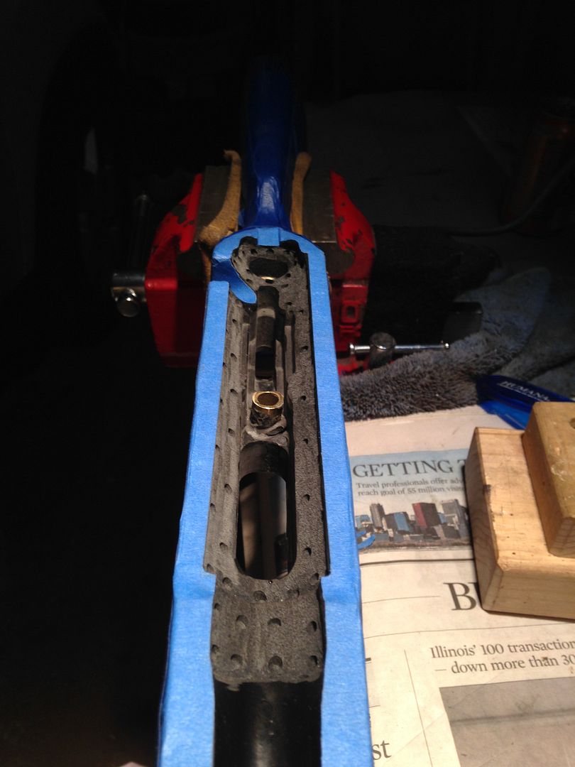

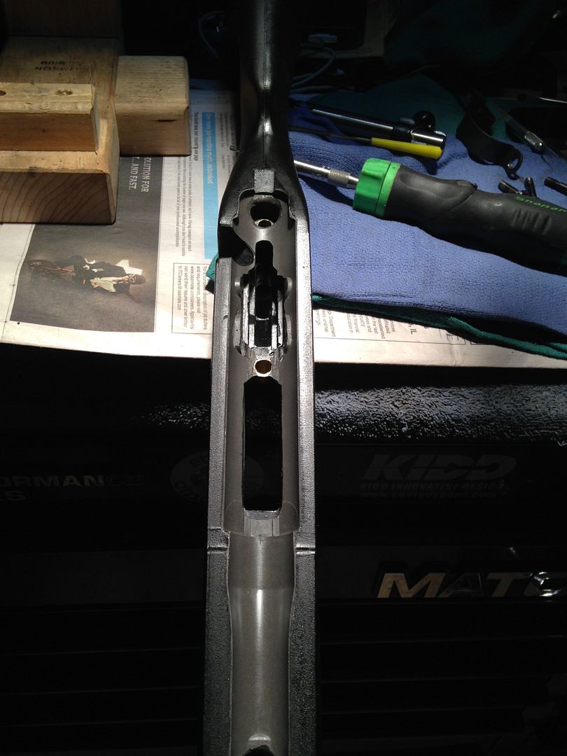

I've had no problems getting Devcon Liquid Steel *Putty* to adhere to polymer stocks. I've done 3 Archangel Dlx Target stocks and 2 OEM CZ 452 Silhouette stocks. Roughed up with 80 grit and Dremel bits, the Devcon bonded VERY well-
Before:
After:
Archangel- Sorry, no "before" pics:
They're both holding up 2 years later.
Devcon 10110
