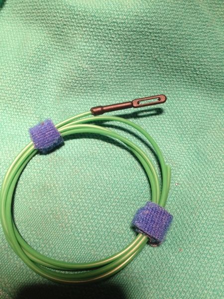

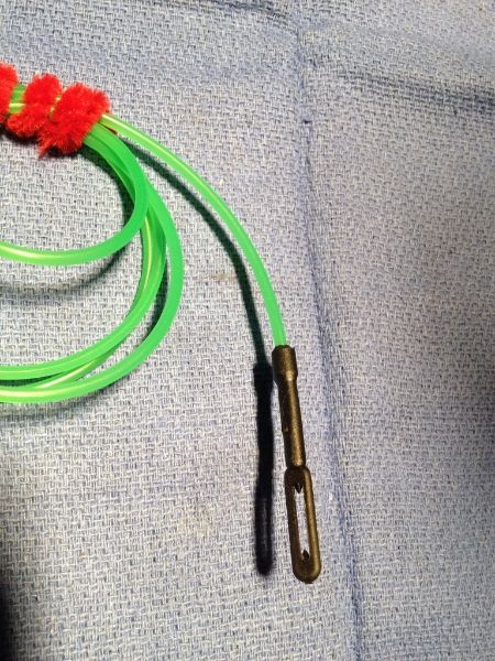

The Gunner Jagsnake- this allows you to apply powder solvent and/or copper solvent and oil/lube to the bore with minimal friction:

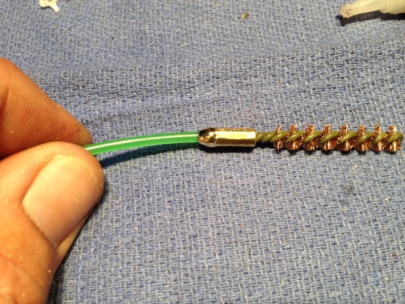

The Gunner Brushsnake: this allows you to brush most bores without disassembling the rifle. For .22s, it MUST be made from the Otis brushes listed below, because they are the only ones that allow a deep enough drill hole, and the brass sticks best to the cyanomethacrylate glue I use. For other calibers, any brush will work, but the ones made of brass hold up best. Aluminum does work, provided that the drill hole is deep enough to allow adequate surface area for the adhesive.
I don't use them on my target barrels, but they work great on my .22s that see bulk/copper washed ammo. I recently made one for 7.62mm and its working out fine- you just need to remember to let the trimmer line twist as you pull so the brush follows the rifling.
They can be made for any caliber.
