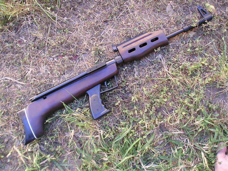

The Chinese QB 57 in .22 bore is take-down springer and is NOT light, about 7 lbs. Breaks down into a satchel sized package though, I call it an urban hunter. :)
This is it assembled.
