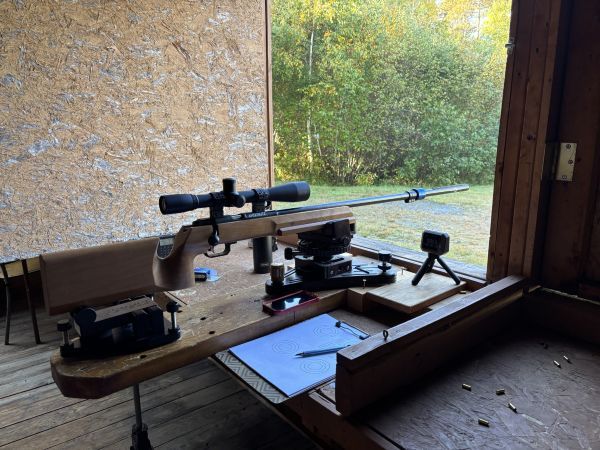

This morning it was cool at 5 degrees Celsius (40 F) and still foggy enough at first to make seeing the target at 100 a bit of a challenge. It soon cleared. Most importantly, it was very calm -- at least for a while. The first bull was encouraging. The fourth was perhaps the best I've seen.
The four ten-shot group average was under .650".
The rifle, a 54.30, is shown below as it was this morning.

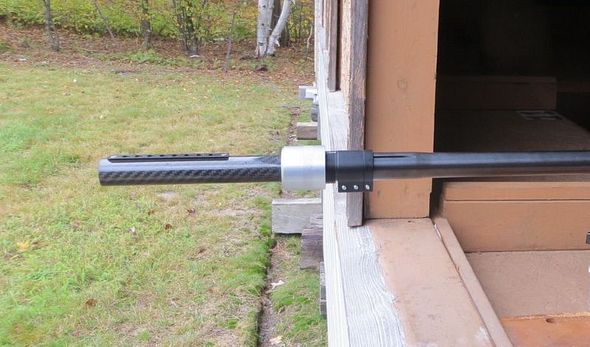

Is it adjustable?
I have seen them on some rifles I compete against shooting indoor 50 foot bullseye.

Is it adjustable?
Yes, it's adjustable. Otherwise it would be a tube with a weight not a tuner! The muzzle end of the tube is threaded, and the weight can be screwed in or out. It's the same principle as BR-orientated tuners.
Starik tubes are quite popular here in the UK, due to availbility and reduced weight thanks to the carbon fibre tube.

gunr, the Starik is a tuner with a carbon tube. As a tuner it's adjustable. It's length is based on the Purdy "Prescription" formula for a particular length barrel.
While it's very difficult to prove that a tuner works at 100, it's also equally difficult to prove it doesn't. I suspect that tuner effectiveness diminishes with distance, but it seems to help at 100 yards. I have had more "good" results with one than without. Of course, this is not a conclusive determination as it's based on outdoor results and what's likely a comparison of samples too small in size.
The Starik tuner has provisions to mount a front sight, which, of course is not used with a scope. Increasing sight radius may be desired when using a front sight.
The weight is rotating, not sliding. There's no need for a threaded barrel as the Starik tuner is clamped to the muzzle.
I don't have a close-up of the tuner on the rifle in question, but below is a "short" Starik tuner on another Anschutz rifle.
