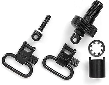

I bought a youth Mossberg 500 for my son. The front sling stud is missing. Mossberg wants an entirely reason $4 for the sling stud and washer, but $11 to $40 in shipping. If I want the sling stud in time for our Thanksgiving hunting trip, I need to spend $40 in shipping.
Any recommendations? I live right outside Washington, DC, but I'll be driving the back route to Massachusetts if anyone knows a gun shop along the way or a website with faster (and reasonable shipping).
