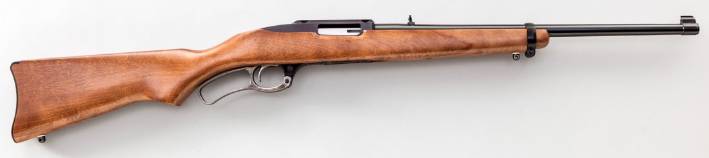

Just checking to see if there are any fans of this oddball
The one everyone thinks is a 10/22... until they see the lever
Then they go :confused:
I have two 96's, one in LR and the other in WMR, both bought in the 90's
They have always just been used as fun "plinkers" to goof around with
I haven't scoped either, irons only so I have no idea how accurate they really are
The irons must be loose or something because they seem to be getting less accurate (no I'm not getting older ;) )
Instead of scoping them I was thinking of keeping them fun and simple...
Maybe putting on an MRDS of some sort
I was even thinking of trying one of the fiber illuminated RMR's (no batteries)
Some folks have the 12moa triangle and use the tip as their zero
If not then I guess a low power fixed like a 2.5x
Again, light... simple... fun :)
